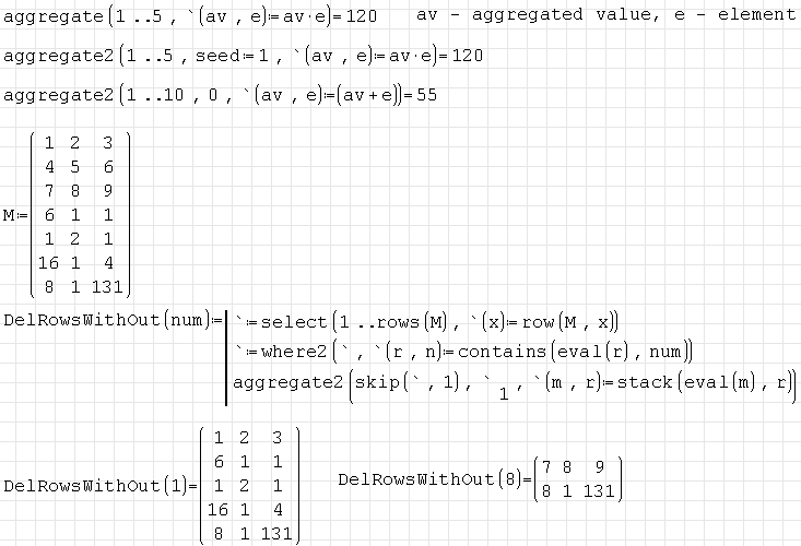

Updated. Small improvements.
P.S. Here, the aggregate function is implemented not correctly.

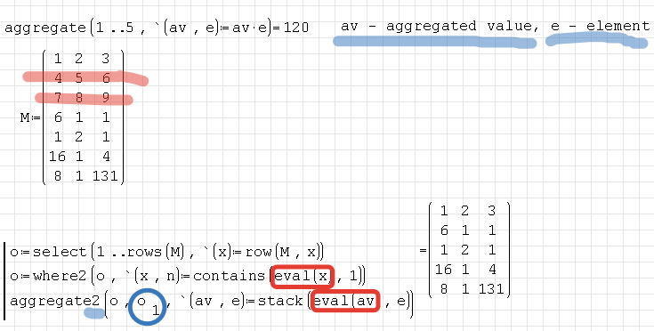

Updated. aggregate() - fixed.

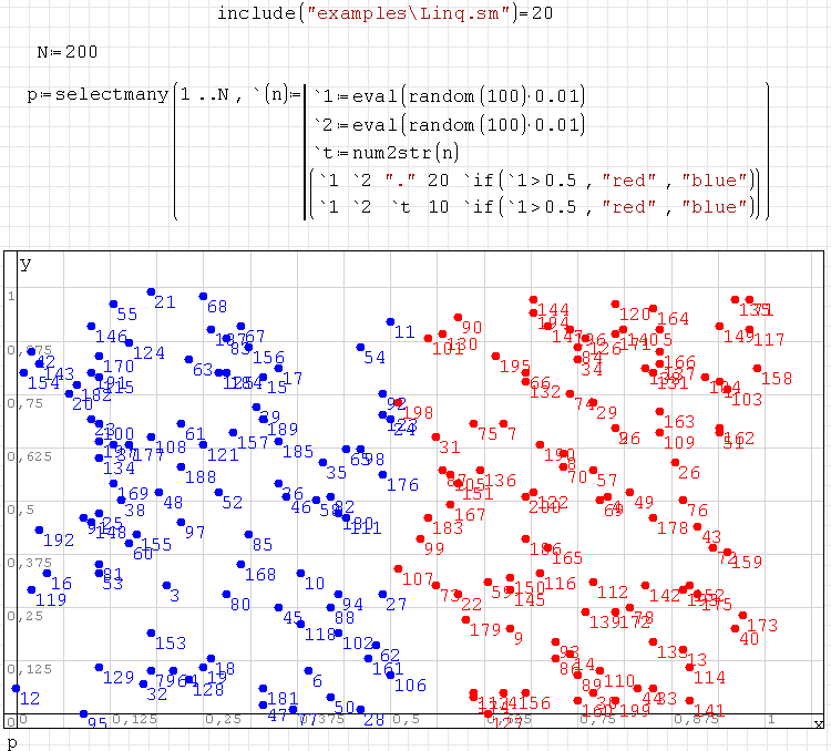

selectmany example.

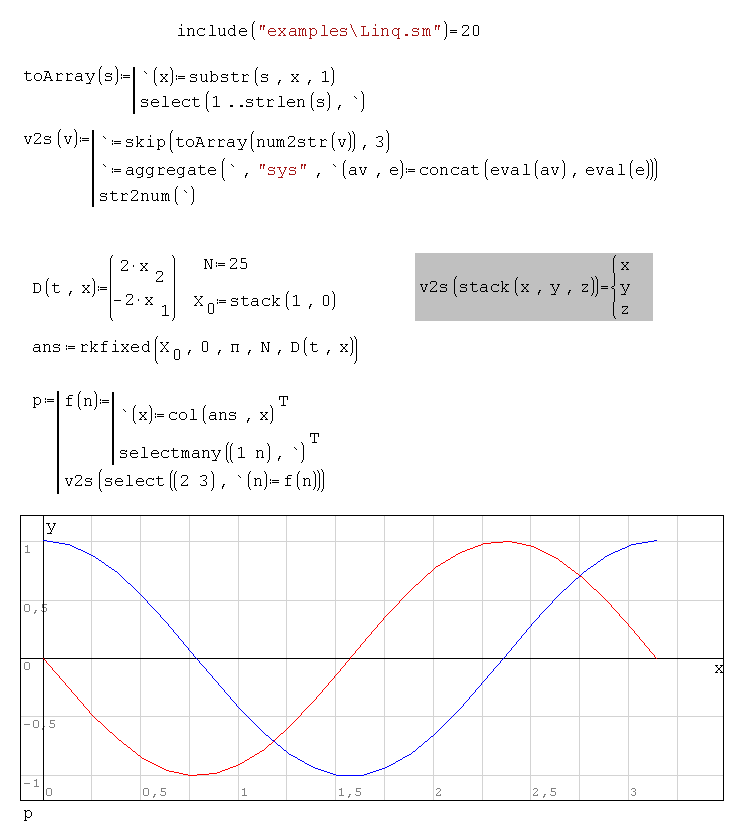

ODE plot.
