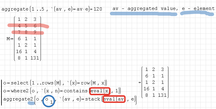

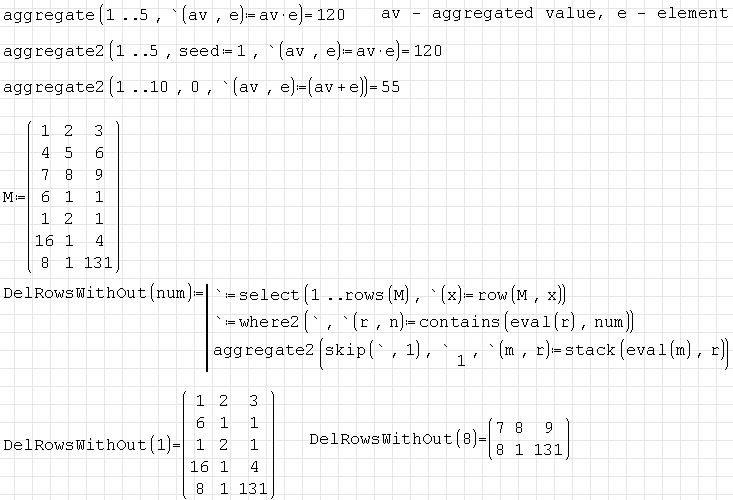

#6 Posted: 4/25/2014 6:30:30 AM
1,558 likes in 1,868 posts.
Updated. Small improvements.
P.S. Here, the aggregate function is implemented not correctly.
Mike Kaganski 4/25/2014 8:16:00 AM

#8 Posted: 4/25/2014 8:58:34 AM
Updated. aggregate() - fixed.
Davide Carpi 4/25/2014 9:42:00 AM

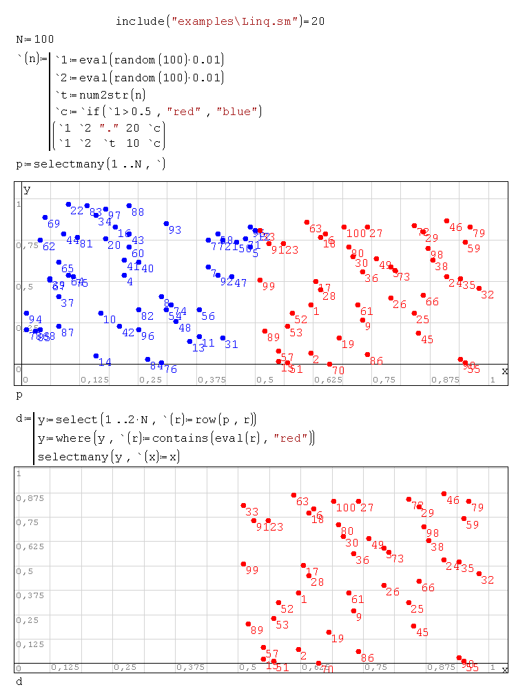

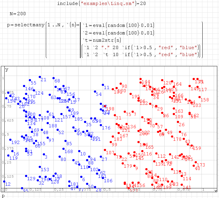

#13 Posted: 4/25/2014 6:57:58 PM
Plot example.
Linq. Plot.sm (7.04 KiB) downloaded 1292 time(s).
Radovan Omorjan 4/26/2014 2:42:00 AM, Davide Carpi 4/25/2014 9:10:00 PM

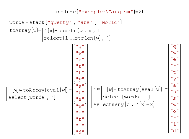

#14 Posted: 4/25/2014 7:22:45 PM
selectmany example.
Linq. selectmany.sm (7 KiB) downloaded 1262 time(s).

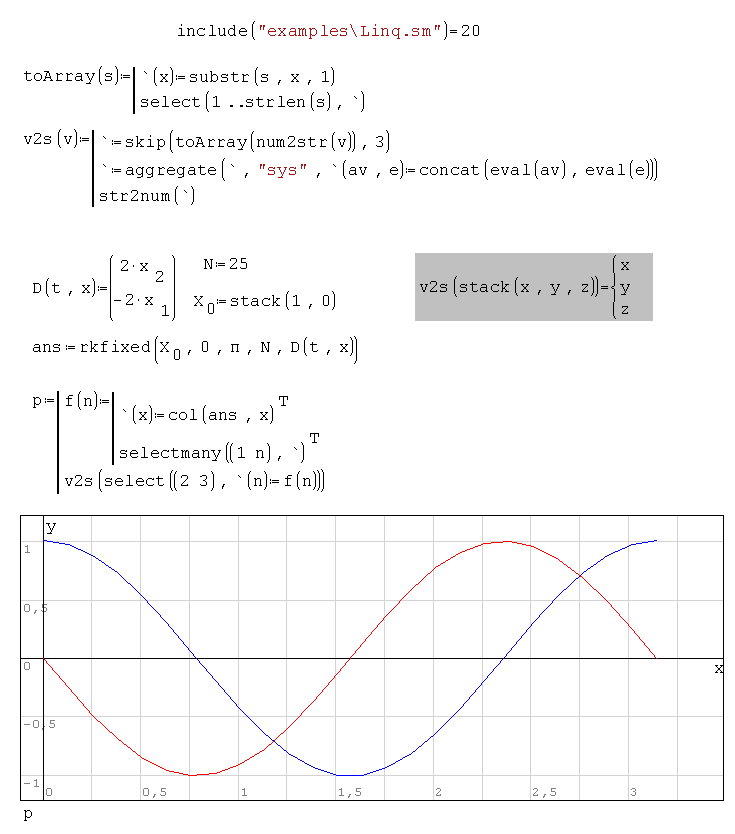

#15 Posted: 4/25/2014 8:43:19 PM
ODE plot.
Linq. ODE plot.sm (10.3 KiB) downloaded 1311 time(s).
Radovan Omorjan 4/26/2014 2:43:00 AM, Davide Carpi 4/25/2014 9:10:00 PM
