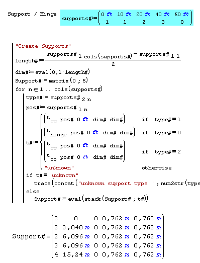

Quick question:
Is there a good way to "recognize and strip" units? Currently we define what units we are working in. I would like to directly input the values into the function I would need to recognize which units are being used, then strip them, then re-apply them at the end.
Thanks again.
Thanks again.
Can you take a look at the attached (scroll down to you see big red text with "problem with cases". I seem to be having a problem with cases(). Maybe there is a better way in general to handle this situation.
Thanks again for your help Martin.
FEA Beam - Decon - Preprocessor.sm (125.54 KiB) downloaded 1080 time(s).
Switch the optimization to numeric (use an eval when you are inside a loop), otherwise you can't mix numbers and strings...
moreover matrix(#,0) is not supported (0 columns) and is converted by SMath into a mat(#,0) - that is a broken mat() function
About units, I think you may define "design base units (lenght/mass/force)" on the top of your worksheet, like in a common FEM program...
FEA Beam - Decon - Preprocessor.sm (127.77 KiB) downloaded 1118 time(s).
Davide, Thanks for the reply.
First let me establish the problem.
I have and input matrix w.p# in which you can define a partial uniform load, a triangular load or a trapezoidal load. However, I need to break down any trapezoidal loads into a uniform load and a triangular load. Therefore I need create a new matrix (change the origonal) which will have 2 columns for every trapezoidal load.
I see your adjustments and at first I had done this. However this creates a "0" column vector for each load, whether it was uniform, triangular or trapezoidal. I was trying to avoid these extra '0' loads by stacking and defining the matrix as "nothing". Similar to how Martin initializes a matrix E=matrix(0,5) and then stacks it will other matrices. I attached another worksheet for reference but it appears the problem is the 'nothing' matrix.
Beam FEA - partial load cases.sm (33.56 KiB) downloaded 1085 time(s).
You're welcome
Excuse me, but as an engineer your approach seems to me unnecessarily complicated
Why you don't use something like in the attachment? [you may also extend it with a 2nd if statement to check if the load is triangular]
Beam FEA - partial load cases.sm (35.77 KiB) downloaded 1073 time(s).
Ahh!
I had thought the number of columns needed to match for the augment() function. Thanks again. I will probably add one for the triangular load case, just to avoid the 0 load matrix column.
Side question - what do you typically use for your engineering calculations? I mean for a substitute to hand calcs, not FEA packages? I've started to learn python as I'd like to see what that has to offer. I like the potential of SMath, in that I'd like something that you can create a calc package that reads like a report (that's my problem with excel) and that is easy to print and navigate. The main problem right now is handling large data tables and speed. Anyway, thanks again.

I receive another odd error using cases.
First error - see attached, BEAM FEA - partial load cases_2
Second Error see attached, BEAM FEA - partial load cases_3
I suspect they are related but not sure how.
Side question -> is there a way for my image to show when using dropbox? Rather than having to click on the 'broken link' image?
Beam FEA - partial load cases_3.sm (29.21 KiB) downloaded 1073 time(s).
I'm not offended, I've just postponed the answer and... forgot about it :d
Excluding (commercial) FEA packages, there are useful free tools here and there, some excel spreadsheet, and there is also some good free FEA program (like OpenSees).
IMHO the main issue of self-made programs is that if you don't have feedbacks from a community, you spend a lot of time and energy for something that might contain a lot of hidden bugs and probably will be set aside in favor of something else when you will have to modify or expand it to some particular case (because the complexity, the time available, ...)
About the latest issues, the key is again the optimization. You have to set it to numeric (using eval() where you can't do it for some reason)
cases() is nothing else that an interface to a nested if/else structure. Because if/else is not supported by SMath's integrals, I've extended cases with a mathematical/boolean version of that nested structure; this is triggered when you choose the symbolic optimization. Thus If cases() with symbolic optimization contains elements that cannot be summable (matrices with different sizes, strings, etc), the summation fails and an error is returned.
About dropbox, the reason because we can't see the images is probably because the link is the link to a page that contains an image, and not to the image itself; to have a link to the image, replace ?dl=0 with ?raw=1

What is the best way to implement this. For some reason I can't seem grasp the best way to insert or remove rows from matrices (which is a big problem for most programs!)...
If I understand correctly the FEM beam function... to create a "Fixed" support I need to have a t.cw and a t.cphi at the same position. Therefore I need to create a new matrix with an extra support "type" at the same position. What is the best way to do this? See attached for portion of the routine that I am referring to.
Thanks!
Thanks!

Thank you Martin!
Well here it is. Not sure how stable it is as I have only limited testing. I wish the graph was easier to move around.
My next effort with be to allow multiple E, I inputs, but for now I will use this mostly for simple span beams.

RFreund, any instructions on how to use those files? I just get errors without changing any parameters, seems something is missing.
I will work on some instructions, sorry about this.
They need to be used in the same work sheet. I've attached them in the same sheet. The idea is that the input and result can be used multiple times on a page, for multiple beams. In order to get the graph to work you must click on it, then right click, select template "T", right click again, select predefined layout "P". I actually don't use the graph, and am working on trying to track the reactions at the reactions (more on this later).
I seam to have left out the input graph (included in the attached)
