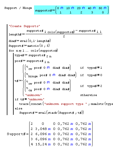

Quick question:
Is there a good way to "recognize and strip" units? Currently we define what units we are working in. I would like to directly input the values into the function I would need to recognize which units are being used, then strip them, then re-apply them at the end.
Thanks again.
Thanks again.
#6 Posted: 2/8/2015 3:47:24 PM
Can you take a look at the attached (scroll down to you see big red text with "problem with cases". I seem to be having a problem with cases(). Maybe there is a better way in general to handle this situation.
Thanks again for your help Martin.
FEA Beam - Decon - Preprocessor.sm (125.54 KiB) downloaded 1265 time(s).
#7 Posted: 2/8/2015 4:19:44 PM
Switch the optimization to numeric (use an eval when you are inside a loop), otherwise you can't mix numbers and strings...
moreover matrix(#,0) is not supported (0 columns) and is converted by SMath into a mat(#,0) - that is a broken mat() function
About units, I think you may define "design base units (lenght/mass/force)" on the top of your worksheet, like in a common FEM program...
FEA Beam - Decon - Preprocessor.sm (127.77 KiB) downloaded 1318 time(s).
#8 Posted: 2/8/2015 10:02:28 PM
Davide, Thanks for the reply.
First let me establish the problem.
I have and input matrix w.p# in which you can define a partial uniform load, a triangular load or a trapezoidal load. However, I need to break down any trapezoidal loads into a uniform load and a triangular load. Therefore I need create a new matrix (change the origonal) which will have 2 columns for every trapezoidal load.
I see your adjustments and at first I had done this. However this creates a "0" column vector for each load, whether it was uniform, triangular or trapezoidal. I was trying to avoid these extra '0' loads by stacking and defining the matrix as "nothing". Similar to how Martin initializes a matrix E=matrix(0,5) and then stacks it will other matrices. I attached another worksheet for reference but it appears the problem is the 'nothing' matrix.
Beam FEA - partial load cases.sm (33.56 KiB) downloaded 1257 time(s).
#9 Posted: 2/9/2015 11:55:00 AM
You're welcome
Excuse me, but as an engineer your approach seems to me unnecessarily complicated
Why you don't use something like in the attachment? [you may also extend it with a 2nd if statement to check if the load is triangular]
Beam FEA - partial load cases.sm (35.77 KiB) downloaded 1247 time(s).
#10 Posted: 2/9/2015 11:13:28 PM
Ahh!
I had thought the number of columns needed to match for the augment() function. Thanks again. I will probably add one for the triangular load case, just to avoid the 0 load matrix column.
Side question - what do you typically use for your engineering calculations? I mean for a substitute to hand calcs, not FEA packages? I've started to learn python as I'd like to see what that has to offer. I like the potential of SMath, in that I'd like something that you can create a calc package that reads like a report (that's my problem with excel) and that is easy to print and navigate. The main problem right now is handling large data tables and speed. Anyway, thanks again.
#11 Posted: 2/15/2015 12:42:29 PM
Davide, Hopefully my question did not offend you..., sorry if I did.
I receive another odd error using cases.
First error - see attached, BEAM FEA - partial load cases_2
Second Error see attached, BEAM FEA - partial load cases_3
I suspect they are related but not sure how.
Side question -> is there a way for my image to show when using dropbox? Rather than having to click on the 'broken link' image?
Beam FEA - partial load cases_3.sm (29.21 KiB) downloaded 1251 time(s).
#12 Posted: 2/15/2015 7:32:24 PM
I'm not offended, I've just postponed the answer and... forgot about it :d

What is the best way to implement this. For some reason I can't seem grasp the best way to insert or remove rows from matrices (which is a big problem for most programs!)...
If I understand correctly the FEM beam function... to create a "Fixed" support I need to have a t.cw and a t.cphi at the same position. Therefore I need to create a new matrix with an extra support "type" at the same position. What is the best way to do this? See attached for portion of the routine that I am referring to.
Thanks!
Beam FEA - Support inserting into matrix.sm (8.87 KiB) downloaded 1253 time(s).
Thanks!

Well here it is. Not sure how stable it is as I have only limited testing. I wish the graph was easier to move around.
My next effort with be to allow multiple E, I inputs, but for now I will use this mostly for simple span beams.
I also want to create a "steel beam size optimization routine". The problem though is importing the steel beam sizes and properties. The matrix is just so large that it really slows the calculation down.
BeamFEA_1 Input-Result.sm (39.74 KiB) downloaded 1260 time(s).

They need to be used in the same work sheet. I've attached them in the same sheet. The idea is that the input and result can be used multiple times on a page, for multiple beams. In order to get the graph to work you must click on it, then right click, select template "T", right click again, select predefined layout "P". I actually don't use the graph, and am working on trying to track the reactions at the reactions (more on this later).
I seam to have left out the input graph (included in the attached)
Things still to impliment:
1. There are variables used in the functions which are still "dangerous" because they can be used outside of the function and cause errors. Namely I have found "l" (lower case "L") to be an issue.
2. Allow input for a change in E and I for different spans. I'm not sure the best way to setup input for this. Right now I really wanted something for simple beams.
BeamFEA Functions - Input and Result.sm (238.46 KiB) downloaded 1341 time(s).
