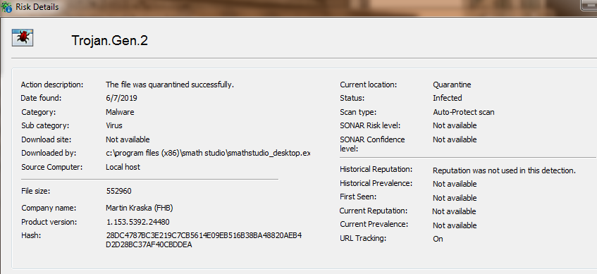

I know this is an old thread, but this is a question on BeamFEA, so...
Symantec Anti-virus keeps quarantining the BeamFEA.exe application as a Trojan Horse virus. This is the file downloaded directly through the Extensions Manager/Applications dialog. Is there any chance this file has somehow become infected? I've had issues with antivirus programs removing legitimate programs I was beta testing due to a lack of "reputation" or widespread use before, but this time it specifically says that reputation was not used in the quarantine decision, and it actually re-quarantines it immediately if I try to restore it. Could someone confirm that the BeamFEA.exe file available through the Extensions Manager is clean of any viruses? Thanks!
Jason

The executables in the extension manager are generated on Andrey's server based on the SVN sources. Thus, he is the only one who can really know.
You can, however, download the executable in your browser using the link [url=vhttps://en.smath.com/view/BeamFEA/summary]https://en.smath.com/view/BeamFEA/summary[/url]
WroteCould someone confirm that the BeamFEA.exe file available through the Extensions Manager is clean of any viruses? Thanks!
If I save a 160 kB Smath work sheet as *.exe,
it does save as 1.6 MB !!!
Win 7 no AV does not open back,
... like Martin mentioned: personal Andrey.
