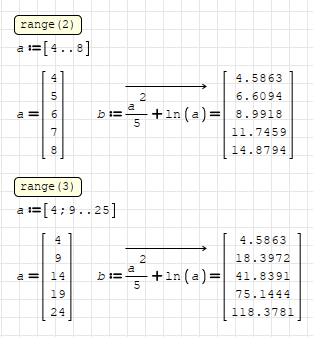

Need to get a solution for some data (for example: values a 4, 5, 6, 7...)
You can use range() functions.
