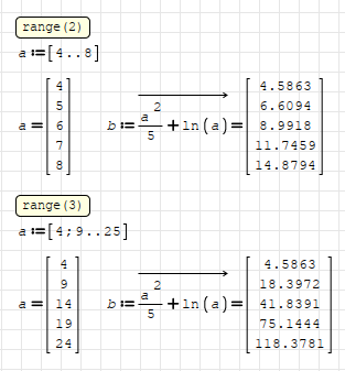

How it is better to set then an array of the data? Need to get a solution for some data (for example: values a 4, 5, 6, 7...)
Matrix didn't work either.
Hi. Supposedly, vectorize operates only on matrices.
Need to get a solution for some data (for example: values a 4, 5, 6, 7...) Matrix didn't work either.
It should have worked. Do you have an example of how it didn't work?
You can use range() functions.
