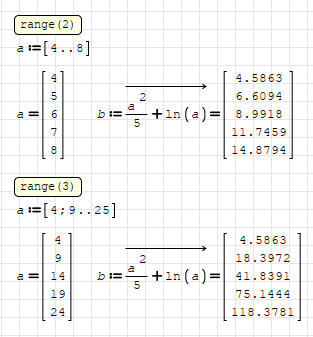

#6 Posted: 9/2/2023 8:35:19 PM
600 likes in 1,381 posts.
How it is better to set then an array of the data?
Need to get a solution for some data (for example: values a 4, 5, 6, 7...)
You can use range() functions.
