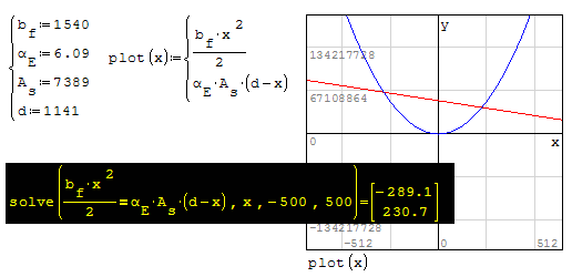

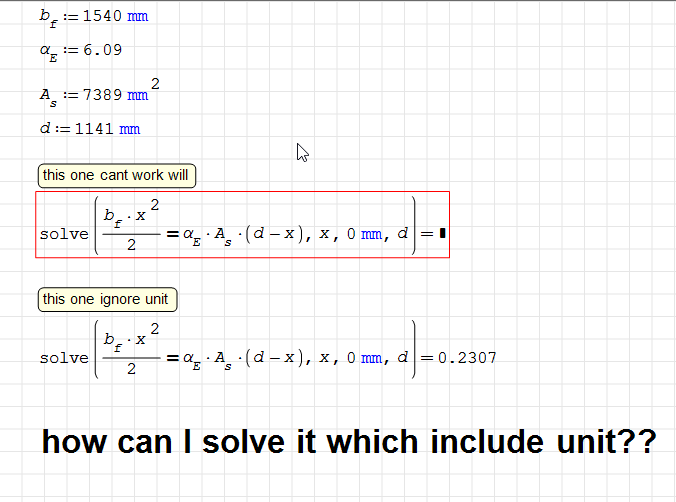

I think solve function cant solve with unit,who can help me?
Test about solve.sm (5.89 KiB) downloaded 1456 time(s).
#5 Posted: 2019/10/22 18:15:16
manolo
manolo
8 likes in 9 posts.
Try this:
#6 Posted: 2019/10/22 18:19:06
Why not work maths as they exist from the cave man, i.e: unitless ?

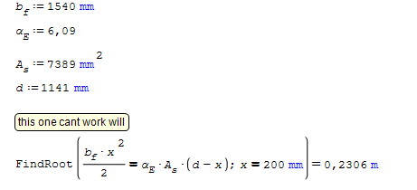

#7 Posted: 2019/10/23 06:07:38
127 likes in 342 posts.
You can also use FindRoot from the NonLinearSolvers plugin, well documented, for details, in Martin Kraska guide

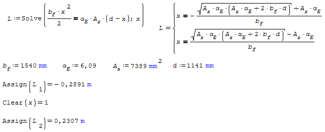

This is the version with the Maxima plugin:
solveunits.sm (7.86 KiB) downloaded 1439 time(s).
sergio 2019/10/24 04:23:00

Try this:
in this way, I need install maple?
I am try to solve EQ with unit. Thank you too!
#12 Posted: 2019/10/23 16:39:40
Jacques CHEN
Jacques CHEN
0 likes in 11 posts.

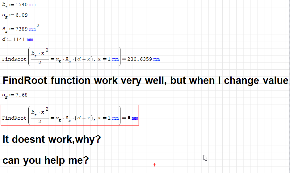

Thank you! this way is very good. But I find another problem.
Test about solve.sm (6.49 KiB) downloaded 1479 time(s).
#13 Posted: 2019/10/23 17:10:47
1,355 likes in 2,271 posts.
FindRoot performs implicit assignment to x.
Therefore, you have to Clear(x) before you can solve for x again. Just as demonstrated in the Maxima example above. There, the solution is assigned explicitly using Assign() from the Maxima-Plugin
See Interactive Handbook> Function Index> Assign or Solve
#14 Posted: 2019/10/23 18:05:54
Jacques CHEN
Jacques CHEN
thank you sir. I solve my problem!

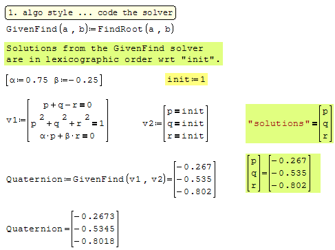

Solve Given_Find [System Demo epsilon].sm (25.89 KiB) downloaded 1275 time(s).

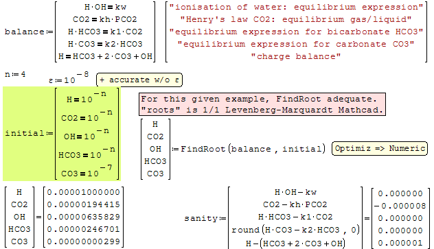

#16 Posted: 2019/10/24 11:09:03
Read carefully the attached.
Read even more carefully the attached.
All in all: Smath solvers has solved all Mathcad 11 great projects.
The bugger in Smath FindRoot is 'ε'
i.e: needed or detrimental [detrimental in attached Butler].
To make it clear, Mathcad Given Find is Mathsoft proprietary.
It has no competition in difficult applications.
Some projects toke weeks, from brain storm collaboration.
Cheers ... Enjoy Butler.
Solve Given_Find [CO2_6179].sm (34.34 KiB) downloaded 1309 time(s).

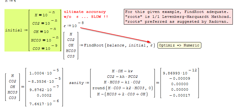

#17 Posted: 2019/10/24 12:48:45

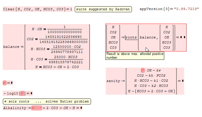

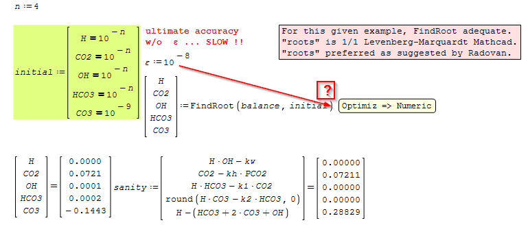

Hello Jean,
It seems something is wrong here. Results seems to be doubtful and I think epsilon is missing as a third argument in FindRoot()
If I add it
Playing with the fourth argument will give
Moreover, roots() will fail
#18 Posted: 2019/10/24 17:54:18
Hello Jean,
Quite right Radovan, many things don't cut the mustard !
1. "roots" fails in your version, but superb in my native SS 6179.
2. "epsilon" deteriorates the solver in this FindRoot application.
3. The system reacts like proportional/commutative wrt reactants.
What matters is the balance [Alkalinity] 0.0000012
sounds pretty good to me ? Should revisit the paper problem,
Reference: Butler, Carbon Dioxide Equilibria, Prob. 2-11, pg 41
