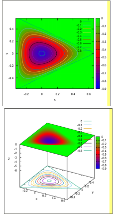

Vibrations of a triangular membrane
Calculation formulas are taken from thearticle:
http://ivdon.ru/uploads/article/pdf/IVD_44__1_Chernyshov.pdf_30f490557a.pdf
Vibration triangular membrane.sm (319.69 KiB) downloaded 1239 time(s).

Vibrations of a triangular membrane(Maxima)
TriangularMembrane Maxima.sm (279.28 KiB) downloaded 1350 time(s).
