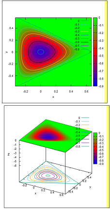

I tried to use the plugin Maxima
PlateMaxima.sm (143.87 KiB) downloaded 1474 time(s).
Andrey Ivashov 1/24/2018 4:37:00 PM, frapuano 1/24/2018 7:43:00 PM
#8 Posted: 1/25/2018 11:52:49 PM
Thanks Ber7, I love those 3D, though it will never beat Mathcad 8... 11.
On my own, I published several times more than the entire Mathcad Community.
I don't miss them in Smath 6179, why ? purely useless for the Engineer.
They are just for the Gallery [Tom G. would say Peanut Gallery].
We are just waiting for a stable Smath version delivered with Maxima plugin
and more of the possible plugins. Scilab looks far superior to Maxima ?
