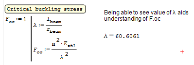

I am using the Line (programming) function for a calculation.
Firstly, apologies, I cannot get the line function to display as maths in the forum so I have had to bodge it in with some text.
Say I have a line function like this:
a:=1
b:=2
|c:=b^2+2 . . = 7
|c
|a+c
Then I would like to be able to display the result of 'c' in the line function. The variable scope of c is limited to within the line function (which is good), but it means I cannot see the value.
So it would look something like this:
|c:=b^2+2 . . = 7
|c = 6
|a+c
I have attached a worksheet showing this in more detail.
Thanks in advance

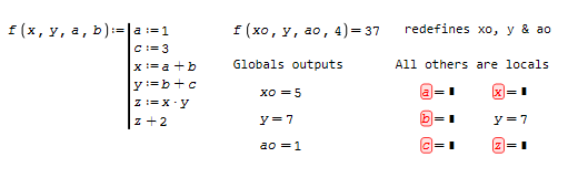

#8 Posted: 2023/7/25 23:36:58
1,123 likes in 1,795 posts.
... I assume that above the maths you have shown in your post, you have separately defined xo:=5, y:=7 etc. ...
Hi. Nope. What you see is the entire worksheet, there are not hidden code there, sorry for not having attached it, for laziness. xo, y & ao turns global only after calling f(xo,y,ao). Before they could have some value or be undefined.
That ability to modify the values of the arguments passed to a function, whether or not they are defined, is unique to SMath and is not present in maple, mathematica or matlab, at least not in a simple way.
additional result.sm (6.99 KiB) downloaded 1159 time(s).
#9 Posted: 2023/7/26 01:49:02
Peter Johns
Peter Johns
2 likes in 11 posts.
Alvaro,
I didn't know you could pass variable by reference, rather than by value, into a function.
I think that is a solution to the problem. It also has the advantage that it can insert all the variables into global scope in one go.
For completeness I have added your method to the my example worksheet, and also upload a second worksheet ( "Section Properties" ) so the calculation can actually be done. The "path" variable should automatically point SMath at the directory where "Additional Programming Result 2.sm", so it will find "Section Properties.sm" providing they are both saved in the same directory. If not then the path variable can be adjusted to suit.
Alvaro, many thanks once again for your help with this
Additional Programming Result 2.sm (21.81 KiB) downloaded 1210 time(s).

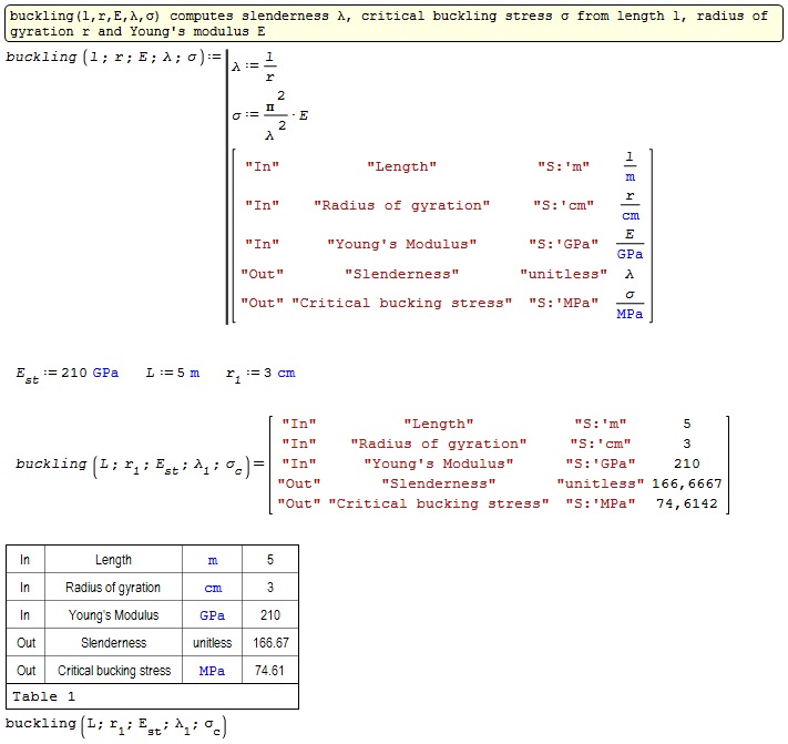

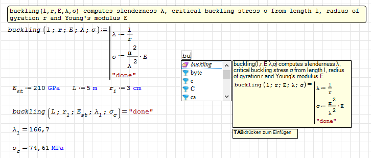

Casting the computations into block functions with no reference to context variables from inside removes any restrictions on variable names in the sheet. With a proper description such functions become self-documenting. This way you can create portable collections of such functions (and store them as snippets).
Blatt22.sm (5.76 KiB) downloaded 1188 time(s).

Hi. Pushing Martin's solution one little step further.
Blatt22 ver 2.sm (18.86 KiB) downloaded 1195 time(s).
Blatt22 ver 2.pdf (82.91 KiB) downloaded 694 time(s).

#15 Posted: 2023/7/27 00:31:35
Peter Johns
Peter Johns
Thanks Martin,
Your implementation is simpler than mine. The reason I went for a slightly more complex version was to reduce the possibility of errors.
For example, if you have a function that computes the second moment of area of a box girder then you would be listing lost of dimensions in the function definition with similar names all in the same units, for example:
[MATH lang:eng]SecondMomentOfAreaBoxGirder(w.tf, t.tf, w.bf, t.bf, d.wb, t.wbr, t.wbl, a.wbr, a.wbl)[/MATH]
Getting one of these around the wrong way may have a significant effect on the result, but be hard to spot. If they are listed in the line function, as I have done, then the order is not important, so one way of generating errors is removed.
The reason I want to use included sheets for this is because some of the functions were becoming very long and a little unwieldy. For complex functions, I find having a worksheet become a function a simpler way to do things, but there are instances where a simple function would be easier.
As above, having more options is good. So thanks again, Martin.

#19 Posted: 2023/7/28 05:44:09
1,355 likes in 2,271 posts.
Thanks Martin,
Here is a easy way to get a summary for procedural implementations of algorithms. You just insert a table region, write your function to the placeholder and do some format adjustments. In the example I just switched from fixed to variable width of table columns and set the font to arial.
Unfortunately, the decimal separator setting is not respected.
This procedure has full control over units in results display and can be extended to alvaros generalized approach (with then input and output flags being dynamic).
Blatt22.sm (12.98 KiB) downloaded 1184 time(s).
