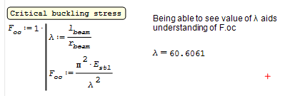

I am using the Line (programming) function for a calculation.
Firstly, apologies, I cannot get the line function to display as maths in the forum so I have had to bodge it in with some text.
Say I have a line function like this:
a:=1
b:=2
|c:=b^2+2 . . = 7
|c
|a+c
Then I would like to be able to display the result of 'c' in the line function. The variable scope of c is limited to within the line function (which is good), but it means I cannot see the value.
So it would look something like this:
|c:=b^2+2 . . = 7
|c = 6
|a+c
I have attached a worksheet showing this in more detail.
Thanks in advance

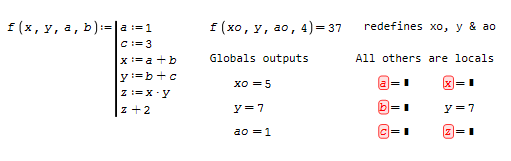

#8 Опубликовано: 25.07.2023 23:36:58
... I assume that above the maths you have shown in your post, you have separately defined xo:=5, y:=7 etc. ...
Hi. Nope. What you see is the entire worksheet, there are not hidden code there, sorry for not having attached it, for laziness. xo, y & ao turns global only after calling f(xo,y,ao). Before they could have some value or be undefined.
That ability to modify the values of the arguments passed to a function, whether or not they are defined, is unique to SMath and is not present in maple, mathematica or matlab, at least not in a simple way.
additional result.sm (6,99 КиБ) скачан 1345 раз(а).
#9 Опубликовано: 26.07.2023 01:49:02
Peter Johns
Peter Johns
2 сообщений из 11 понравились пользователям.
Alvaro,
I didn't know you could pass variable by reference, rather than by value, into a function.
I think that is a solution to the problem. It also has the advantage that it can insert all the variables into global scope in one go.
For completeness I have added your method to the my example worksheet, and also upload a second worksheet ( "Section Properties" ) so the calculation can actually be done. The "path" variable should automatically point SMath at the directory where "Additional Programming Result 2.sm", so it will find "Section Properties.sm" providing they are both saved in the same directory. If not then the path variable can be adjusted to suit.
Alvaro, many thanks once again for your help with this

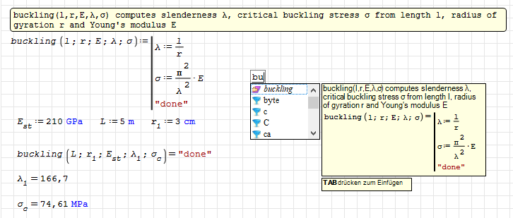

#11 Опубликовано: 26.07.2023 10:33:32
I am trying to think simple.
Maybe sys() is what you looking for.

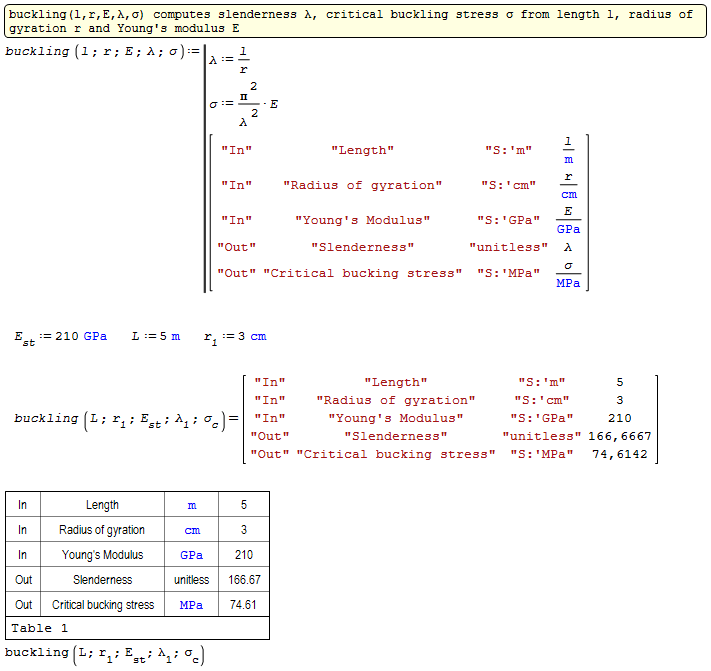

Hi. Pushing Martin's solution one little step further.
Blatt22 ver 2.sm (18,86 КиБ) скачан 1379 раз(а).
Blatt22 ver 2.pdf (82,91 КиБ) скачан 838 раз(а).
#14 Опубликовано: 27.07.2023 00:06:06
Peter Johns
Peter Johns
Thanks Overlord,
The sys() function does exactly what I wanted in a really simple way. You can use an index on the result to pick out the single value you want, whilst having the others displayed.
Alvaro's solution is still also very useful, as it introduces a number of other possibilities as well.

Here is a easy way to get a summary for procedural implementations of algorithms. You just insert a table region, write your function to the placeholder and do some format adjustments. In the example I just switched from fixed to variable width of table columns and set the font to arial.
Unfortunately, the decimal separator setting is not respected.
This procedure has full control over units in results display and can be extended to alvaros generalized approach (with then input and output flags being dynamic).
Blatt22.sm (12,98 КиБ) скачан 1393 раз(а).
