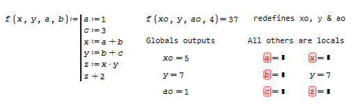

#8 Posted: 7/25/2023 11:36:58 PM
1,139 likes in 1,805 posts.
... I assume that above the maths you have shown in your post, you have separately defined xo:=5, y:=7 etc. ...
Hi. Nope. What you see is the entire worksheet, there are not hidden code there, sorry for not having attached it, for laziness. xo, y & ao turns global only after calling f(xo,y,ao). Before they could have some value or be undefined.
That ability to modify the values of the arguments passed to a function, whether or not they are defined, is unique to SMath and is not present in maple, mathematica or matlab, at least not in a simple way.
additional result.sm (6.99 KiB) downloaded 1345 time(s).
#9 Posted: 7/26/2023 1:49:02 AM
Peter Johns
Peter Johns
2 likes in 11 posts.
Alvaro,
I didn't know you could pass variable by reference, rather than by value, into a function.
I think that is a solution to the problem. It also has the advantage that it can insert all the variables into global scope in one go.
For completeness I have added your method to the my example worksheet, and also upload a second worksheet ( "Section Properties" ) so the calculation can actually be done. The "path" variable should automatically point SMath at the directory where "Additional Programming Result 2.sm", so it will find "Section Properties.sm" providing they are both saved in the same directory. If not then the path variable can be adjusted to suit.
Alvaro, many thanks once again for your help with this

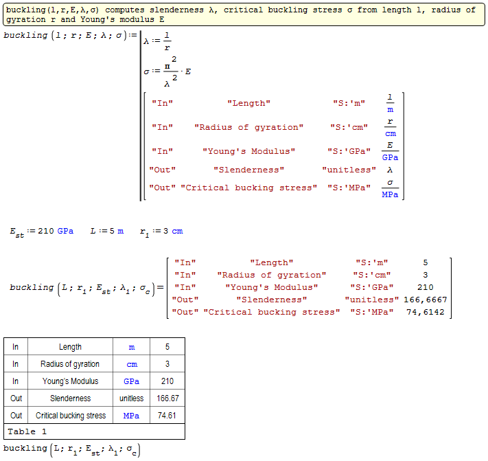

#12 Posted: 7/26/2023 6:55:23 PM
1,361 likes in 2,275 posts.
Casting the computations into block functions with no reference to context variables from inside removes any restrictions on variable names in the sheet. With a proper description such functions become self-documenting. This way you can create portable collections of such functions (and store them as snippets).
Blatt22.sm (5.76 KiB) downloaded 1386 time(s).
Oscar Campo 7/26/2023 6:58:00 PM, NDTM Amarasekera 7/26/2023 10:51:00 PM, Alvaro 7/27/2023 12:04:00 AM

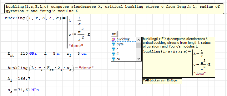

#13 Posted: 7/27/2023 12:03:41 AM
Hi. Pushing Martin's solution one little step further.
Blatt22 ver 2.sm (18.86 KiB) downloaded 1379 time(s).
Blatt22 ver 2.pdf (82.91 KiB) downloaded 838 time(s).

Here is a easy way to get a summary for procedural implementations of algorithms. You just insert a table region, write your function to the placeholder and do some format adjustments. In the example I just switched from fixed to variable width of table columns and set the font to arial.
Unfortunately, the decimal separator setting is not respected.
This procedure has full control over units in results display and can be extended to alvaros generalized approach (with then input and output flags being dynamic).
Blatt22.sm (12.98 KiB) downloaded 1393 time(s).
