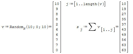

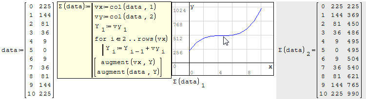

In the attachment at the start of Page.5 I (so far) am unable to construct a loop or something that cumulatively adds vector elements down the column. So I am manually doing this for now, any ideas?
I have started additions from the 6th element because first x4 were zero ...but I think you get the idea!
https://imgur.com/7KSBDM8

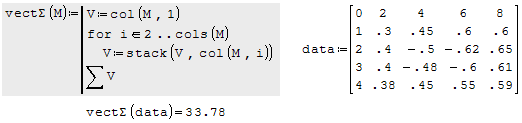

#3 Posted: 2018/4/23 15:03:49
usamakhan
usamakhan
3 likes in 79 posts.
no no ...I think I was unable to make you understand. The summation gives one value ...instead I wanted to have a cumulative elements in a vector. The latter thus can be plotted. please revisit the screenshot

Sum the vectors and vectorize ...

... as you wish

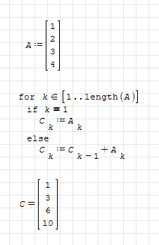

Jean Giraud, why do you add Line in the following code, I mean why not just type them separately or am I missing something?

Jean,
Why did you use Sum(1) with a J loop?
Ioncube,
Just use Sum(4)

#11 Posted: 2018/4/23 20:27:53
1,355 likes in 2,271 posts.
cumsum.sm (3.95 KiB) downloaded 949 time(s).
Yes my friend, you are missing best using Smath feature,
1. the line | collects/instructs the project
2. the { collects for plotting
Visit attached Project PR EOS.sm
Here is your plot and cumulative.
Project PR EOS.sm (129.66 KiB) downloaded 997 time(s).

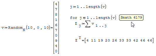

#15 Posted: 2018/4/24 00:28:22
You are right: Martin latest version throws error in my 6179.
Try that in your version.

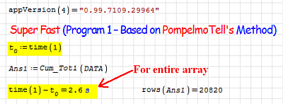

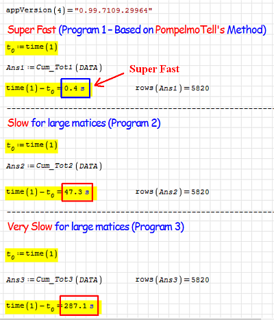

I tested 3 programs to find the cumulative totals of a large array of 20820 elements.
The method of Sergio was incredibly fast, while other two methods were much slower.
Thanks Sergio.

#18 Posted: 2019/8/9 11:33:32
NDTM Amarasekera
NDTM Amarasekera
130 likes in 352 posts.
Hello Alvaro
I get following result in my laptop.
Yours is a very good alternative.
Thanks.
