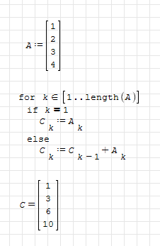

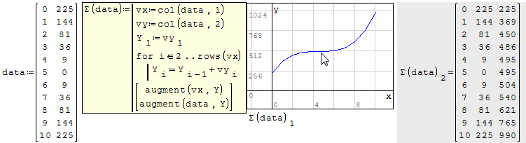

In the attachment at the start of Page.5 I (so far) am unable to construct a loop or something that cumulatively adds vector elements down the column. So I am manually doing this for now, any ideas?
I have started additions from the 6th element because first x4 were zero ...but I think you get the idea!
https://imgur.com/7KSBDM8
Secondly in the last page there is a 2D-graph. One can easily read the intersection of two lines however is there any solution to find the intercept of two lines when they aren't functions but are rather data points?
Remembraning.sm (38.42 KiB) downloaded 1147 time(s).

no no ...I think I was unable to make you understand. The summation gives one value ...instead I wanted to have a cumulative elements in a vector. The latter thus can be plotted. please revisit the screenshot

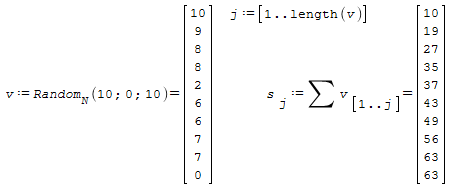

Jean,
Why did you use Sum(1) with a J loop?
Ioncube,
Just use Sum(4)

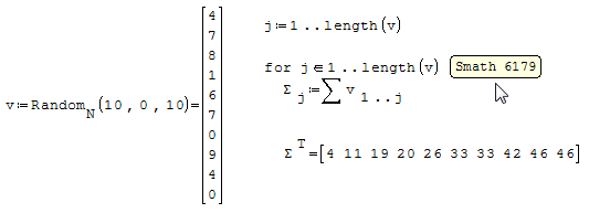

#15 Posted: 4/24/2018 12:28:22 AM
You are right: Martin latest version throws error in my 6179.
Try that in your version.

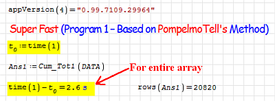

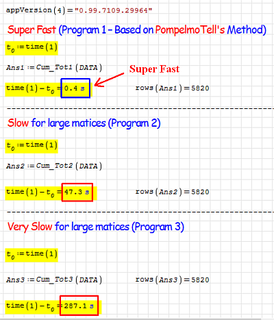

I tested 3 programs to find the cumulative totals of a large array of 20820 elements.
The method of Sergio was incredibly fast, while other two methods were much slower.
Thanks Sergio.
Forgot to attach DATA file
Rainfal_Data.xlsx (486.31 KiB) downloaded 788 time(s).
Cumulative Sum of a Large Matrix.sm (30.38 KiB) downloaded 1162 time(s).
frapuano 8/9/2019 3:43:00 AM

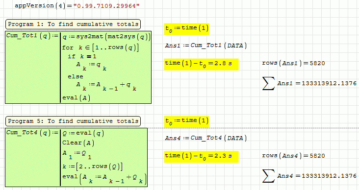

Hi Nugegodage. Try this other one.
Cumulative Sum of a Large Matrix.sm (25.32 KiB) downloaded 1429 time(s).
(Notice that mi computer is very slow)

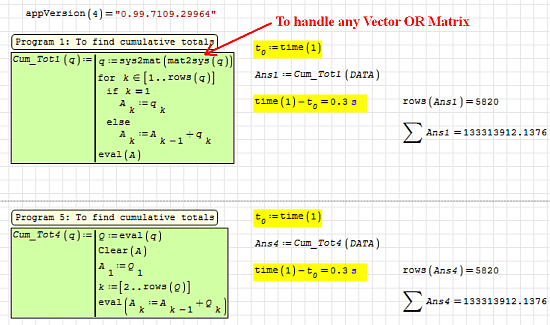

#18 Posted: 8/9/2019 11:33:32 AM
NDTM Amarasekera
NDTM Amarasekera
130 likes in 352 posts.
Hello Alvaro
I get following result in my laptop.
Yours is a very good alternative.
Thanks.

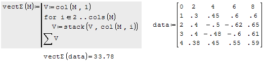

... the word is array
1. Unwrap the array in vector
2. ΣV ... vector sum over the unwrapped array
SS 6179 does not open your document.
