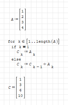

In the attachment at the start of Page.5 I (so far) am unable to construct a loop or something that cumulatively adds vector elements down the column. So I am manually doing this for now, any ideas?
I have started additions from the 6th element because first x4 were zero ...but I think you get the idea!
https://imgur.com/7KSBDM8

Ruben Sidranski
Ruben Sidranski
Sum the vectors and vectorize ...
#6 Опубликовано: 23.04.2018 16:48:03
... as you wish

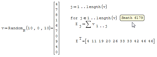

Jean Giraud, why do you add Line in the following code, I mean why not just type them separately or am I missing something?

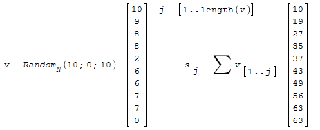

#10 Опубликовано: 23.04.2018 17:13:07
Ruben Sidranski
Ruben Sidranski
Jean,
Why did you use Sum(1) with a J loop?
Ioncube,
Just use Sum(4)

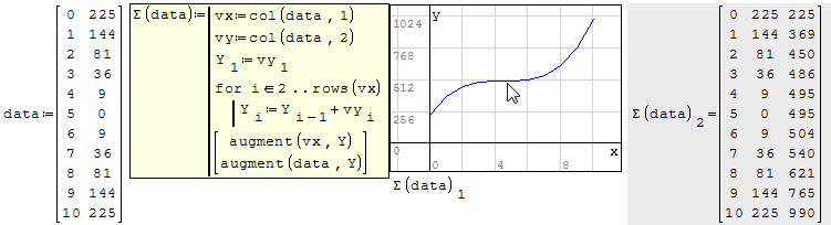

#12 Опубликовано: 23.04.2018 21:47:19
Yes my friend, you are missing best using Smath feature,
1. the line | collects/instructs the project
2. the { collects for plotting
Visit attached Project PR EOS.sm
Here is your plot and cumulative.
Project PR EOS.sm (129,66 КиБ) скачан 1169 раз(а).

The code I provided should work, as it did previous Smath 5346.
#15 Опубликовано: 24.04.2018 00:28:22
You are right: Martin latest version throws error in my 6179.
Try that in your version.

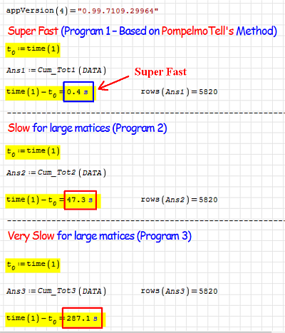

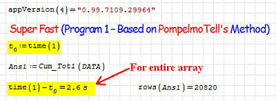

I tested 3 programs to find the cumulative totals of a large array of 20820 elements.
The method of Sergio was incredibly fast, while other two methods were much slower.
Thanks Sergio.
Forgot to attach DATA file
Rainfal_Data.xlsx (486,31 КиБ) скачан 788 раз(а).
Cumulative Sum of a Large Matrix.sm (30,38 КиБ) скачан 1162 раз(а).

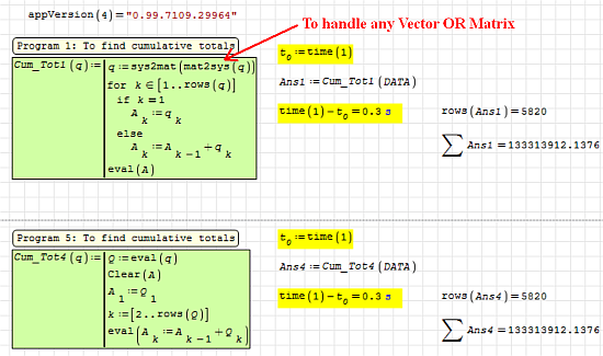

#17 Опубликовано: 09.08.2019 05:38:20
Hi Nugegodage. Try this other one.
Cumulative Sum of a Large Matrix.sm (25,32 КиБ) скачан 1429 раз(а).
(Notice that mi computer is very slow)
sergio 09.08.2019 06:43:00, frapuano 09.08.2019 10:47:00, NDTM Amarasekera 09.08.2019 11:43:00

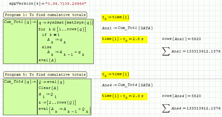

#18 Опубликовано: 09.08.2019 11:33:32
NDTM Amarasekera
NDTM Amarasekera
Hello Alvaro
I get following result in my laptop.
Yours is a very good alternative.
Thanks.

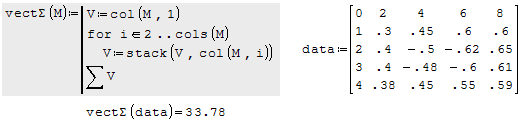

1. Unwrap the array in vector
2. ΣV ... vector sum over the unwrapped array
SS 6179 does not open your document.
#20 Опубликовано: 09.08.2019 19:12:35
...more and otherwise.
vectSum.sm (15,92 КиБ) скачан 1298 раз(а).
