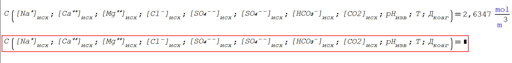

I have corrected but new error message
Predochistka.sm (59.97 KiB) downloaded 1288 time(s).

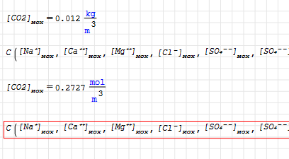

I call the function one more and get an error. Why?
Predochistka-Err.sm (62.61 KiB) downloaded 1306 time(s).

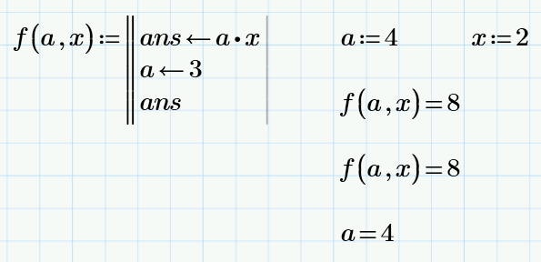

You redefine some function arguments inside the function body. That change its values globally:
See the green area in the document. Also, as an example:
Prime
