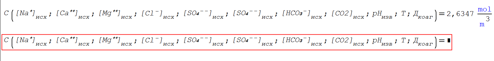

I call the function one more and get an error. Why?
Predochistka-Err.sm (62.61 KiB) downloaded 1474 time(s).

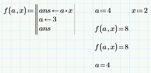

You redefine some function arguments inside the function body. That change its values globally:
See the green area in the document. Also, as an example:
Prime
