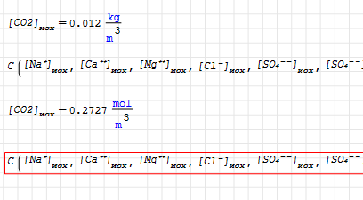

Why we have an error in this SM-sheet

Predochistka.sm (54,45 КиБ) скачан 1452 раз(а).

t is undefined. And why do you have [SO₄‾‾].исх as an argument twice?

Hi. For starting, the vertical bars in the while condition are not for absolute value, but for determinant.
Thanks, Alvaro!
I have corrected but new error message
Predochistka.sm (59,97 КиБ) скачан 1473 раз(а).

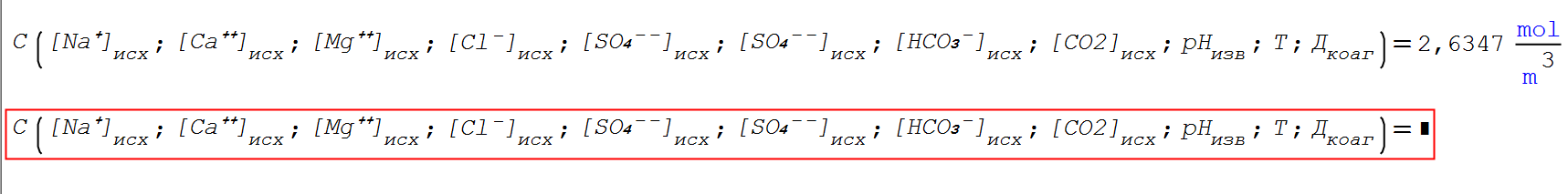

I call the function one more and get an error. Why?
Predochistka-Err.sm (62,61 КиБ) скачан 1474 раз(а).

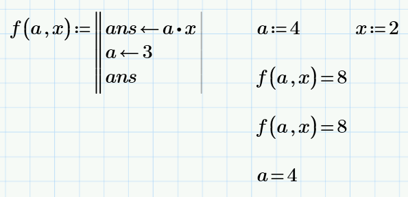

You redefine some function arguments inside the function body. That change its values globally:
See the green area in the document. Also, as an example:
Prime
