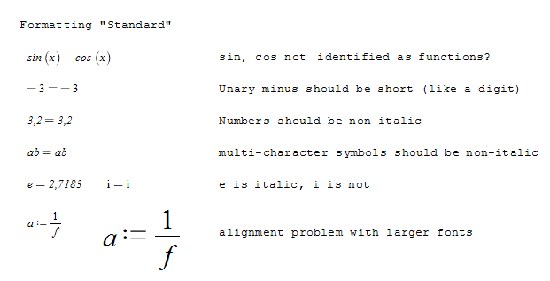

A short test showed the following issues (some of them might be matter of taste). I understand this is work in progress...
formatting.sm (5.5 KiB) downloaded 1434 time(s).
EDIT: The functions are deliberately set to italic in "Standard". Thus this can be fixed using a custom style.

Yes, here is the idea:
1) settings.prop file located in ProgramFiles folder which means it is a part of distribution package and should not be changed by user;
2) During several releases we will test the functionality, so I have allowed to change settings.prop file in order to find the best final presents together with community (final presets will result in more or less equal equation sizes, so changing them will not break layout of already created worksheets);
3) As soon as final presets is determined changing of this file will become impossible or it will be just not suggested anymore;
4) UI will be developed to allow anyone to change presets using some convenient dialog with appropriate options but all the changes will become a part of the worksheet. Meaning that settings.prop file will never be changed.
Regarding errors you found: almost all of them are known (I also have about 10 others). 3-rd one is already fixed and will be a part of the next build. Changes introduced are very complex, so I expect it will take some time to make something close to ideal. But we will do it!
Thank you very much, Martin!

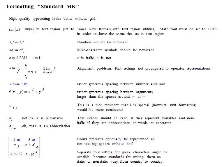

I felt encouraged to play around a bit. I wonder why the font in math regions must be scaled to 120% to result in the same font size as in text regions of the same font.
Perhaps we are entering an era, where people become more picky about appearance issues of SMath sheets. The monospaced text regions become inappropriate now...

I think that ideally in the final draft each user should be able to define his own styles in the %APPDATA% directory, then the attributes of used styles should be included in the header of the worksheet, and the files in the installation directory left untouched. Same thing for units. Just my 2 cents
Martin Kraska 2017/11/7 22:15:00
#8 Posted: 2017/11/7 22:14:38
1,355 likes in 2,271 posts.
Yes, and any user should be able to inspect/modify the definitions embedded in a document, perhaps in the document properties. This also applies for calculation settings. One could provide templates (examples?) with certain sets of settings.

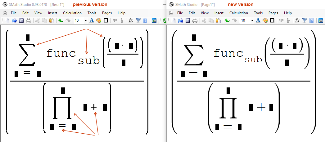

New visualization approach improved and polished. The main change is that now SMath Studio knows if function/variable is defined by user or built-in and based on this different fonts may be used for visualization.
Note: new default formatting preset defined (I plan to use it in the upcoming stable release).
Please try and comment what you think.
Best regards!

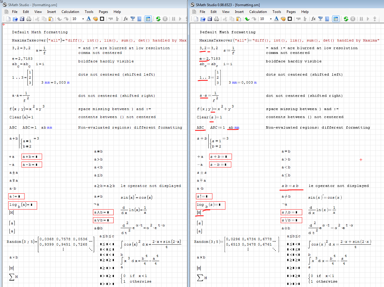

Seems that the boolean operator "greater than or equal to" is not drawn, unrelated to vectorize
I experience some horizontal misalignments (caret position, empty placeholders, ...), I am the only one?
frapuano 2017/11/10 10:02:00, sergio 2017/11/10 08:42:00

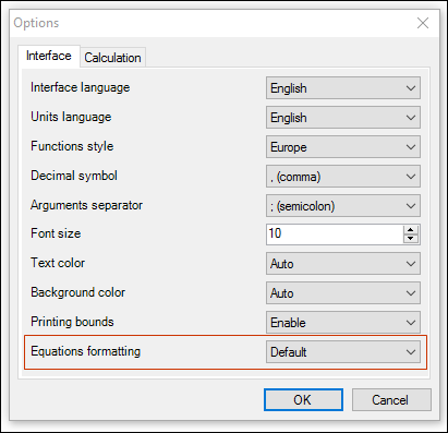

Topic updated: new SMath Studio 0.98.6523 released.
Many improvements done for equations visualization, restoring of performance on calculation and new functionality requested by [USERLINK]Jean Giraud[/USERLINK] implemented.
Please make sure you are using Default equations formatting (in Options dialog) as this preset is now priority 1.
Note: Linux problem is not handled yet.
Please test.

At low resolution/small font size, the old formatting is easier to read, mainly due to the blur of the thin-lined operators.
Pasting multiple regions as image is nice.
When the maxima-plugin is downloaded from the gallery and the offer to search for Maxima is confirmed, then the setup dialog automatically closes instead of waiting for user input. The dialog can only be used after next start of SMath.
Feature proposal: pan the canvas by drag with the middle mouse button (as alternative to use the scrollbars)
formatting.sm (27.85 KiB) downloaded 1439 time(s).

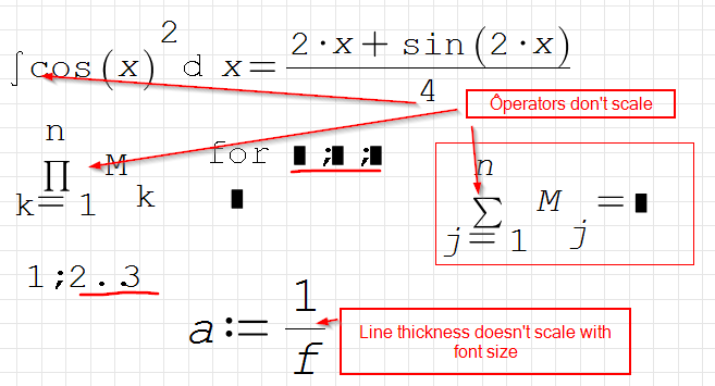

Some issues with higher font sizes:
