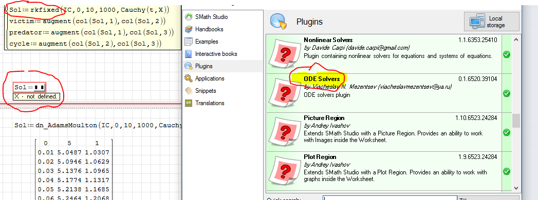

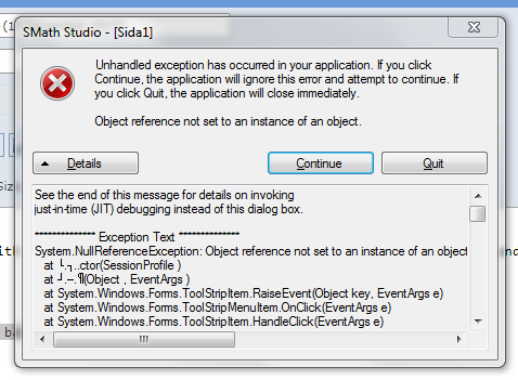

Bumped into the problem of ODE Solvers plugin and the recent build. Started the example for ODE solving from the Martins's Reference book. Tried to delete and reinstall ODE Solvers, example started once and but the problem persisted after the second run.

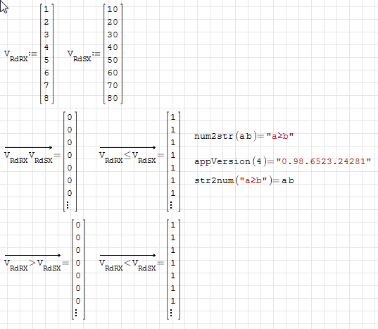

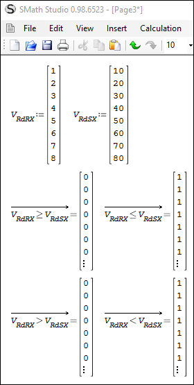

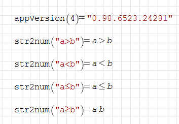

WroteThe reported problem persists (post #11), but it is specified that it is only for the >= and not for <=, > , <.
Hello.
Unfortunately I can't reproduce an issue with >=. Could you please doublecheck? Version is 0.98.6523.
boolean_check_1.sm (5.58 KiB) downloaded 1246 time(s).
Martin has already answered for me.

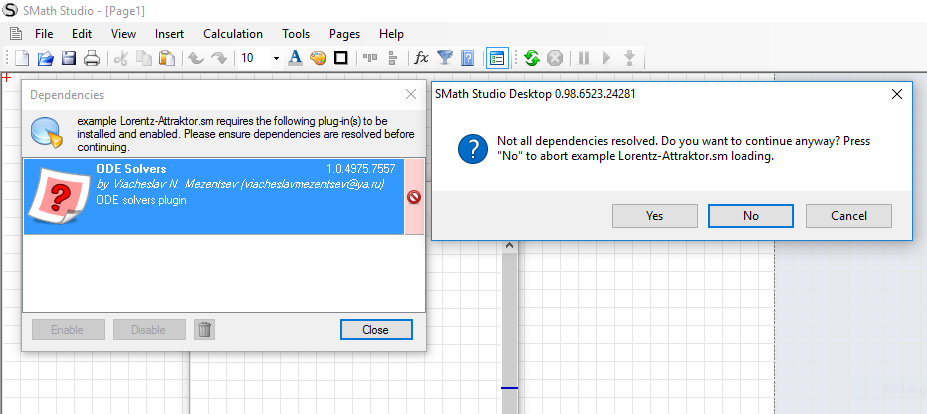

WroteBumped into the problem of ODE Solvers plugin and the recent build.
Just say "Yes continue" and open the work sheet.
Done otherwise: double click on the file from it's location,
"Yes, continue" it should open the work sheet all functional.

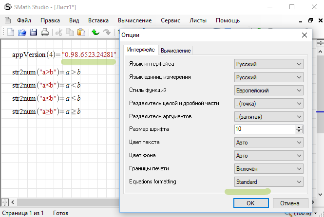

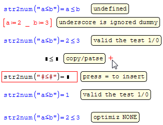

WroteHow about indicating the formatting scheme (e.g. in the status line)?
Bolean should be specified completely. The example > ... < is trivial
If not specified completely, all sorts of error messages will be issued.
Mathcad was more tolerant, thus much less educative than Smath.
DeBoor argument v< ... is however completely specified wrt to its neighbour
if((el(u,μ)≤v)&(v

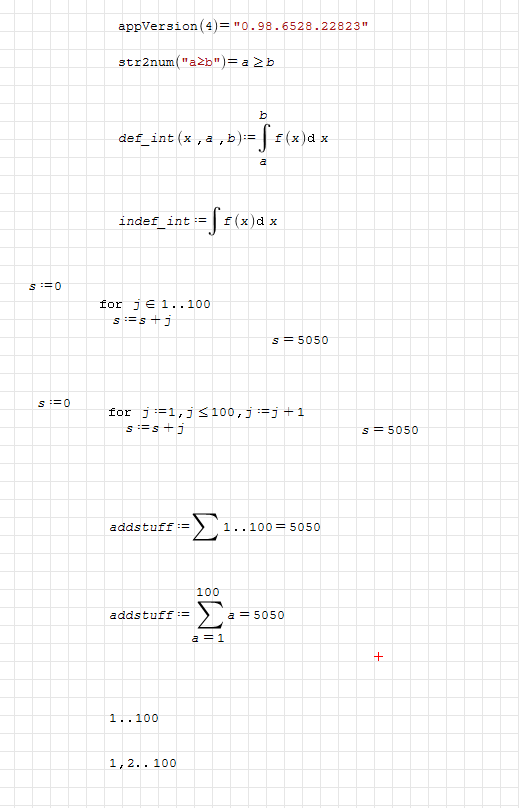

Thank you all for your comments!
Topic updated - new SMath Studio 0.98.6528 released.

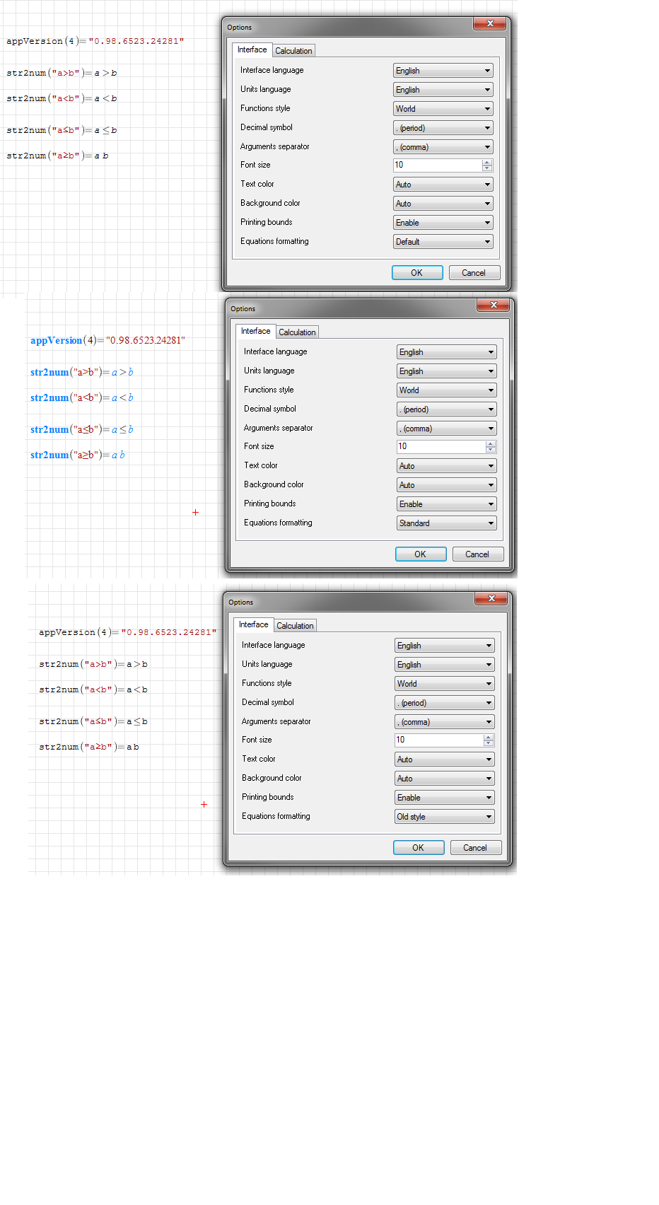

New visualization approach improved again. The main change is that support of Linux restored and "more or equal" operator should be fixed now. Also, the following functions looks much better now: int(2), int(4), for(3), for(4), sum(1), sum(4), product(4), range(2), range(3). On Windows operators do not look blured anymore.
Formatting preset option will be removed from the next build ("Default" will be used as an only built-in one).
Please try and comment.
Best regards, Andrey Ivashov.

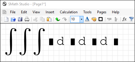

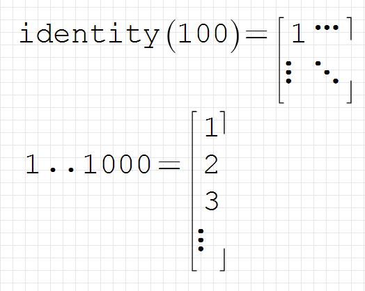

Better

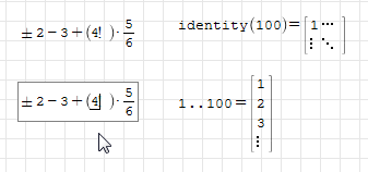

A couple of issues I still found: horizontal alignment of factorial and vertical ellipsis
![2017-11-15 00_27_40-SMath Studio - [Page1.sm_].png](/zh-Hans-CN/files/Download/C7pmoy/2017-11-15-00_27_40-SMath-Studio---[Page1.sm_].png)
Broken right bracket of matrices changing font sizes (starting from 16pt):
![2017-11-15 00_19_21-SMath Studio - [Page1.sm_].png](/zh-Hans-CN/files/Download/aadUMM/2017-11-15-00_19_21-SMath-Studio---[Page1.sm_].png)
EDIT linux still not working for me

Arie 2017/11/15 23:24:00
Thank you very much for the reports!
My stupid error. Already fixed. Sorry.
WroteAlright, so now Ive had several hard crashes when Smath is being used. Seems as if I loose the standard language / grid settings, and when I try to open settings I get this:
![2017-11-11 15_09_08-SMath Studio 0.98.6523 - [boolean_check_1.sm_].png](/zh-Hans-CN/files/Download/ySKQzw/2017-11-11-15_09_08-SMath-Studio-0.98.6523---[boolean_check_1.sm_].png)
