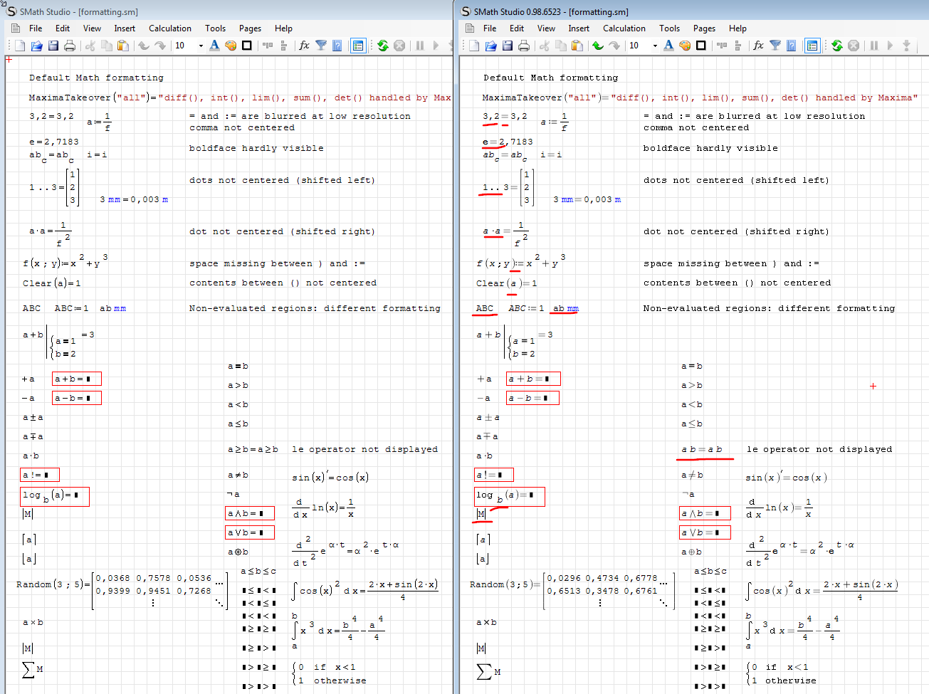

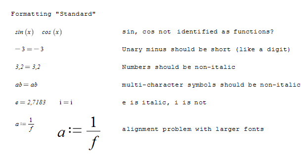

A short test showed the following issues (some of them might be matter of taste). I understand this is work in progress...
formatting.sm (5,5 КиБ) скачан 1640 раз(а).
EDIT: The functions are deliberately set to italic in "Standard". Thus this can be fixed using a custom style.

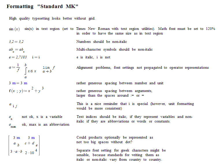

I felt encouraged to play around a bit. I wonder why the font in math regions must be scaled to 120% to result in the same font size as in text regions of the same font.
Perhaps we are entering an era, where people become more picky about appearance issues of SMath sheets. The monospaced text regions become inappropriate now...

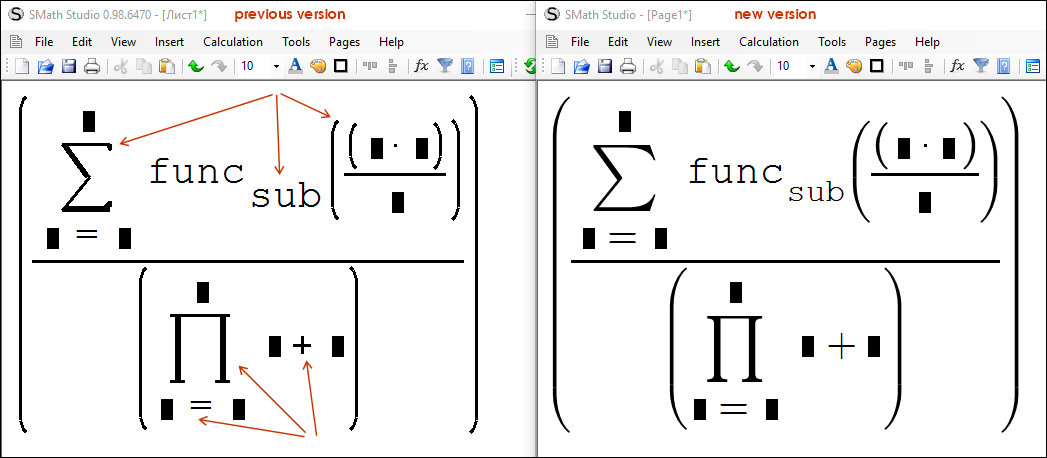

Topic updated - new SMath Studio 0.98.6522 released.
New visualization approach improved and polished. The main change is that now SMath Studio knows if function/variable is defined by user or built-in and based on this different fonts may be used for visualization.
Note: new default formatting preset defined (I plan to use it in the upcoming stable release).
Please try and comment what you think.

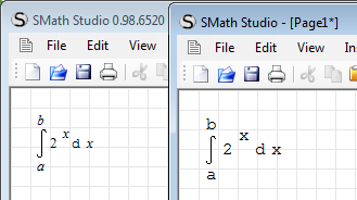

I experience some horizontal misalignments (caret position, empty placeholders, ...), I am the only one?
frapuano 10.11.2017 10:02:00, sergio 10.11.2017 08:42:00
Yes, I'm working hard right now to fix these issues.

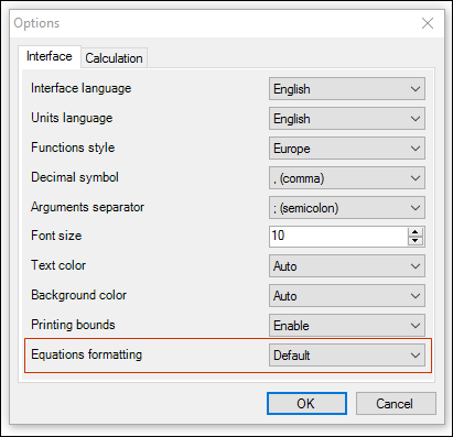

Topic updated: new SMath Studio 0.98.6523 released.
Many improvements done for equations visualization, restoring of performance on calculation and new functionality requested by [USERLINK]Jean Giraud[/USERLINK] implemented.
Please make sure you are using Default equations formatting (in Options dialog) as this preset is now priority 1.

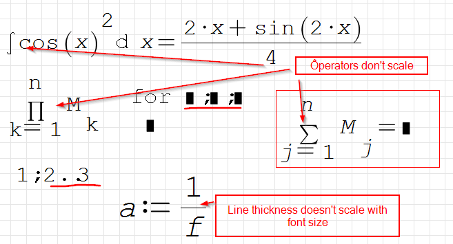

Some issues with higher font sizes:

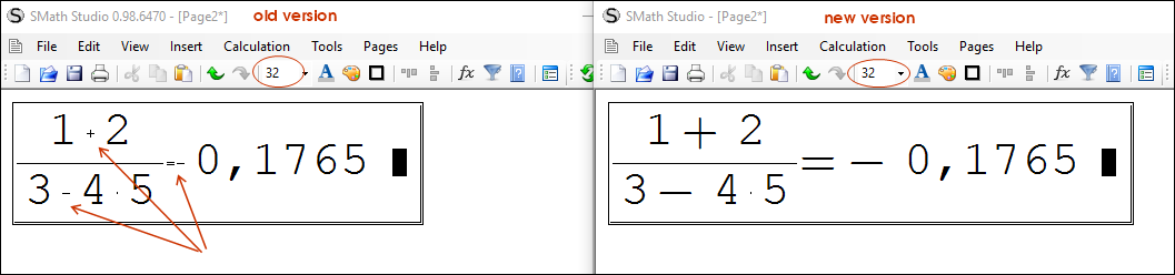

Absolutely loving the changes (and software) - great work.
Ive experienced some strange font scaling issues in in the two latest builds (using the latest right now). As I change the font size using either the settings menu or the toolbar option, the effect seems inversed and interacting with each other. Furthermore, they dont display the correct font scale value. As I press enter in the first image, one expects the typeface to get larger (from 7 to 14), yet the inverse happens. As I open the settings again, it displays a 10, and thus does not remember the latest changes. This effect doesnt appear to be linear, although its hard to notice when scaling.
The problem is not specific to any particular file, but occurs whenever I change font sizes, and persists through restart/new file.
