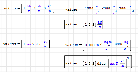

#4 Posted: 2023/6/11 15:32:41
1,123 likes in 1,795 posts.
... I was able to convert mm to m (my database has plain values, but they are supposed to be mm). But next step is to display final results in kN/m, but I keep getting kg/s^2. ...
Hi. Something like this?

#6 Posted: 2023/6/11 18:35:16
598 likes in 1,380 posts.
My guess is his data is something like this.
That's what I deduce from his description at least.
Without him posting datasheet we can't help any further.
