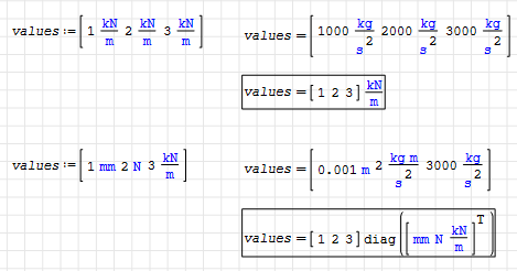

#4 Posted: 6/11/2023 3:32:41 PM
1,111 likes in 1,787 posts.
... I was able to convert mm to m (my database has plain values, but they are supposed to be mm). But next step is to display final results in kN/m, but I keep getting kg/s^2. ...
Hi. Something like this?
My guess is his data is something like this.
That's what I deduce from his description at least.
Without him posting datasheet we can't help any further.

#8 Posted: 6/12/2023 5:29:17 AM
1,442 likes in 2,935 posts.
You have to customize the result units in the rightmost placeholder.
sergio 6/12/2023 5:44:00 AM
Thank you! I don't know how I didn't get that working couple days ago, I tried to write units outside of brackets but didn't succeed. But now it works no problem
