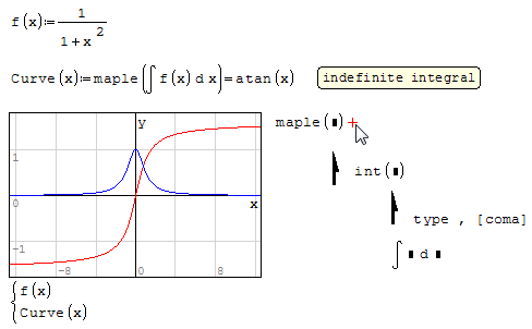

Thankyou. int( x^2,x) was what I was looking for (and I see now what that first picture was suppose to be /headdesk). I tried the example mentioned above with maple installed but I don't see the answer like I saw above. I see this instead.
#14 Posted: 2018/5/11 11:49:59
Arie
Arie
94 likes in 285 posts.
Try right click and change optimization to symbolic.
Also you can use symbolic evaluation by hitting Ctrl + . (That is Ctrl and period) instead of =

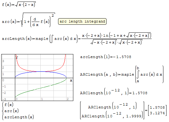

Integrate Wisely [Arc Maple].sm (8.54 KiB) downloaded 932 time(s).
#16 Posted: 2018/5/11 12:43:56
... be productive to integrate, try it.
#17 Posted: 2018/5/11 13:44:31
... this attached example is of prime importance.
It shows by how much the Simpson integrator can be OFF track !
Not even the first decimal is true !
Integrate Wisely [Arc Lagrange].sm (44.76 KiB) downloaded 919 time(s).
