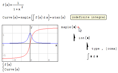

Generally, like this.
Davide Carpi 12.05.2018 03:23:00
#3 Опубликовано: 10.05.2018 22:35:04
... more procedures.
Integrate_000000 [ Source Code Maple].sm (9,66 КиБ) скачан 1358 раз(а).

For reference, I just installed SMath. I installed maple. Where is the integrate sign located in the program?
Hi Ryu
Welcome to the forums. Jean's first post outlined a how to create the indefinite integral, although it might not have been clear.
For example, to create the integral for x^2, you can type "int(x^2,x)" without quotes.
I do not believe there is a toolbar button for the indefinite integral.
-alyles

Thankyou. int( x^2,x) was what I was looking for (and I see now what that first picture was suppose to be /headdesk). I tried the example mentioned above with maple installed but I don't see the answer like I saw above. I see this instead.
#14 Опубликовано: 11.05.2018 11:49:59
Arie
Arie
Try right click and change optimization to symbolic.
Also you can use symbolic evaluation by hitting Ctrl + . (That is Ctrl and period) instead of =

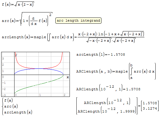

Integrate Wisely [Arc Maple].sm (8,54 КиБ) скачан 1085 раз(а).

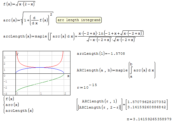

... this attached example is of prime importance.
It shows by how much the Simpson integrator can be OFF track !
Not even the first decimal is true !
Integrate Wisely [Arc Lagrange].sm (44,76 КиБ) скачан 1080 раз(а).
