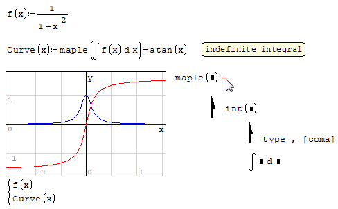

How do I integrate symbolically?
#2 Posted: 5/10/2018 9:54:23 PM
How do I integrate symbolically ?
Generally, like this.

For reference, I just installed SMath. I installed maple. Where is the integrate sign located in the program?

1. Visit Wolfram Alpha for ultimate accuracy definite integral
2. Reproduce my first reply for indefinite integral .
3. Open the two attachments
4. Click on Smath menu to get the palette of stuff.

#11 Posted: 5/11/2018 9:32:38 AM
Arie
Arie
94 likes in 285 posts.
Hi Ryu
Welcome to the forums. Jean's first post outlined a how to create the indefinite integral, although it might not have been clear.
For example, to create the integral for x^2, you can type "int(x^2,x)" without quotes.
I do not believe there is a toolbar button for the indefinite integral.
-alyles

Thankyou. int( x^2,x) was what I was looking for (and I see now what that first picture was suppose to be /headdesk). I tried the example mentioned above with maple installed but I don't see the answer like I saw above. I see this instead.

Try right click and change optimization to symbolic.
Also you can use symbolic evaluation by hitting Ctrl + . (That is Ctrl and period) instead of =

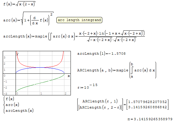

Copy the image, paste in blank work sheet ... try to do it yourself.
Try hard !!! rescue yourself by downloading the work sheet.
It should work in your latest Smath version.
Integrate Wisely [Arc Maple].sm (8.54 KiB) downloaded 1085 time(s).

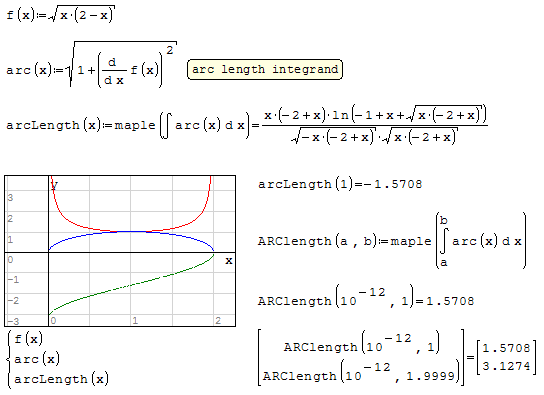

... this attached example is of prime importance.
It shows by how much the Simpson integrator can be OFF track !
Not even the first decimal is true !
Integrate Wisely [Arc Lagrange].sm (44.76 KiB) downloaded 1080 time(s).
