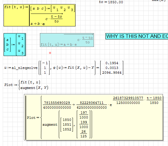

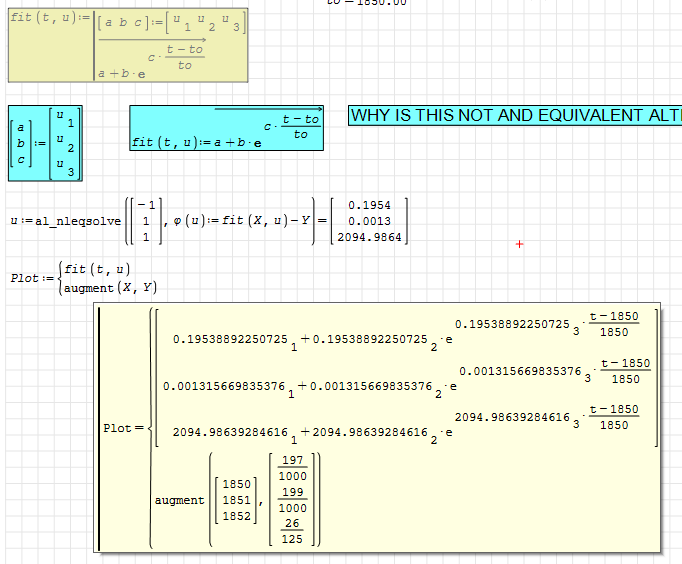

Two questions:
1. How can the plot of f(t,u) work because t is never defined?
2. I don't understand why my alternate formalism in the cyan box is not equivalent.
Thanks,
Reg
To analyze the second option, the nleqsolve set up is correct, but Plot fails to find the values of a,b,c inside the fit function.
As a final comment, XY Plot can graph expressions with any unknown, while SMath's native plot can also do so, but only with the variable "x".
I hope this clarifies a little why the second option doesn't work.

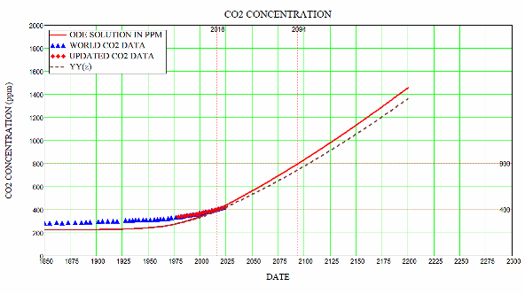

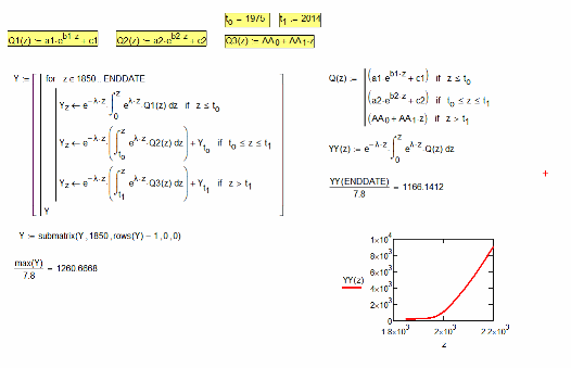

I have attached a pdf of my MATHCAD file that supposedly does the same calculation. There are small differences here also, but they manifest in a rather large difference in the result when the emission model reaches 1.5 °C. MATHCAD predicts 2128 and SMATH predicts 2120 for the same input constants…I think.
But we physicists usually do estimates to an order of magnitude. We are very happy with a factor of two. Our difference of 1233.2524/1156.6686 =1.07 makes us ecstatic.
MATHCAD CO2 FORCING.pdf (603.43 KiB) downloaded 992 time(s).
CO2 FORCING WITH SMATH.pdf (1 MiB) downloaded 921 time(s).

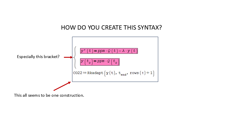

Two things;
1. How do you create this syntax for Rkadapt.
2. Your integral over tk is equal to my Y as far as I can tell.
CO2 FORCING SATURATION STUDY NEW.sm (599.66 KiB) downloaded 1686 time(s).
I have tried numerous things, but I still don't understand the difference in the two methods.
Thanks much.
Reg
Wrote... 1. How do you create this syntax for Rkadapt. ...
It is the syntax for an ode solver using the "Mathcad toolbox"
Wrote... 2. Your integral over tk is equal to my Y as far as I can tell.
Thank you for confirming that I am not making some basic mistake, at least the mistake is somewhat hidden, in case there is one. If it were a derivative, one can expect anything, since it is a very unstable numerical procedure, but when it comes to integrals it is supposed to be stable and robust. What's more, it is supposed to be continuous on the right, but one can always find examples that complicate things.
