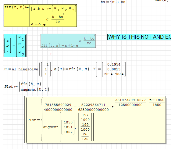

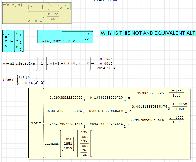

1. How can the plot of f(t,u) work because t is never defined?
2. I don't understand why my alternate formalism in the cyan box is not equivalent.

Hi Reg. You can see the result stored in Plot by hovering over it. In the case of the first option, Plot stores a one-variable expression (i.e., a single unknown, t) and a two-column matrix, so the graphs will be a univariate function and a set of points on the plane.
To analyze the second option, the nleqsolve set up is correct, but Plot fails to find the values ​​of a,b,c inside the fit function.
As a final comment, XY Plot can graph expressions with any unknown, while SMath's native plot can also do so, but only with the variable "x".
I hope this clarifies a little why the second option doesn't work.

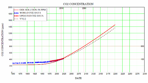

My version has a discrepancy with yours, although I don't understand where it could be: I check them and according to me they should be the same. (Area in yellow)
CO2 FORCING SATURATION STUDY 2.sm (116,6 КиБ) скачан 1854 раз(а).

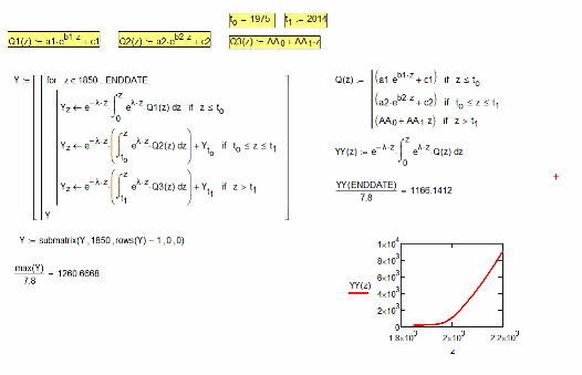

I can only assume it is differences in the order of calculation between the two methods. Note that there is a slight difference between u.lin1 and u.lin2 in our versions. I assume it is the difference in how we define the subset of data between 2014 and 2023.
I have attached a pdf of my MATHCAD file that supposedly does the same calculation. There are small differences here also, but they manifest in a rather large difference in the result when the emission model reaches 1.5 °C. MATHCAD predicts 2128 and SMATH predicts 2120 for the same input constants…I think.
But we physicists usually do estimates to an order of magnitude. We are very happy with a factor of two. Our difference of 1233.2524/1156.6686 =1.07 makes us ecstatic.

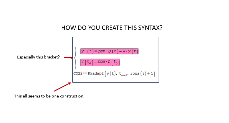

1. How do you create this syntax for Rkadapt.
2. Your integral over tk is equal to my Y as far as I can tell.
CO2 FORCING SATURATION STUDY NEW.sm (599,66 КиБ) скачан 1921 раз(а).
I have tried numerous things, but I still don't understand the difference in the two methods.

... 1. How do you create this syntax for Rkadapt. ...
It is the syntax for an ode solver using the "Mathcad toolbox"
... 2. Your integral over tk is equal to my Y as far as I can tell.
Thank you for confirming that I am not making some basic mistake, at least the mistake is somewhat hidden, in case there is one. If it were a derivative, one can expect anything, since it is a very unstable numerical procedure, but when it comes to integrals it is supposed to be stable and robust. What's more, it is supposed to be continuous on the right, but one can always find examples that complicate things.
