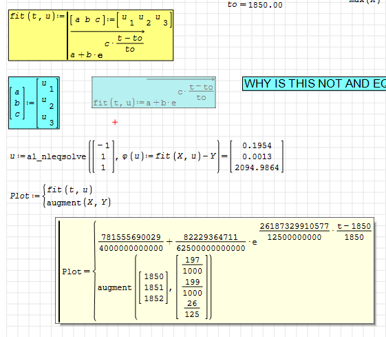

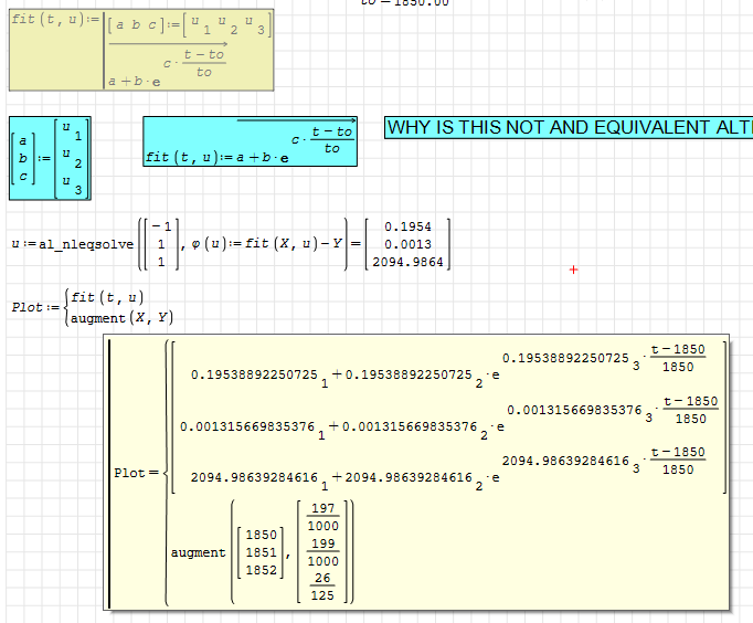

Razonar first gave me this formalism for al_nleqsolve. His formalism works perfectly; however, mine does not.
Here is my example SMATH file.
AL_NLEQSOLVE FIT.sm (20.48 KiB) downloaded 1706 time(s).
Sorry, I forgot to upload the data file. Here it is.
WORLD EMISSION DATA VS DATE.xlsx (24.74 KiB) downloaded 1280 time(s).
Two questions:
1. How can the plot of f(t,u) work because t is never defined?
2. I don't understand why my alternate formalism in the cyan box is not equivalent.
Thanks,
Reg
Reg CurryLoveland, CO
#2 Posted: 2/13/2025 8:36:48 AM
1,134 likes in 1,805 posts.
Hi Reg. You can see the result stored in Plot by hovering over it. In the case of the first option, Plot stores a one-variable expression (i.e., a single unknown, t) and a two-column matrix, so the graphs will be a univariate function and a set of points on the plane.
To analyze the second option, the nleqsolve set up is correct, but Plot fails to find the values ​​of a,b,c inside the fit function.
As a final comment, XY Plot can graph expressions with any unknown, while SMath's native plot can also do so, but only with the variable "x".
I hope this clarifies a little why the second option doesn't work.

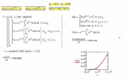

#10 Posted: 2/17/2025 5:47:23 AM
... Infrequently, SMATH crashes on me. It may be my 10 year old computer. When I include a separator in my file, and then try to move it with the mouse, it totally destroys all of my graph settings to the point that I have to delete the graphs and start over. This is how I move areas; so I thought I could move the separator the same way. If I add and delete spaces with the cursor and my keyboard that works fine. So, I have stopped using separators.
On my Windows too, on 32 and 64 bit machines. If I want to move an area, I collapse it, cut it and paste it to the desired destination.
My version has a discrepancy with yours, although I don't understand where it could be: I check them and according to me they should be the same. (Area in yellow)
CO2 FORCING SATURATION STUDY 2.sm (116.6 KiB) downloaded 1817 time(s).
CO2 FORCING SATURATION STUDY 2.pdf (634.17 KiB) downloaded 1076 time(s).

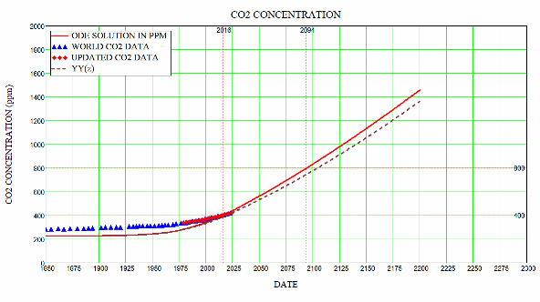

#11 Posted: 2/17/2025 7:46:05 AM
RegRetired
RegRetired
8 likes in 144 posts.
I can only assume it is differences in the order of calculation between the two methods. Note that there is a slight difference between u.lin1 and u.lin2 in our versions. I assume it is the difference in how we define the subset of data between 2014 and 2023.
I have attached a pdf of my MATHCAD file that supposedly does the same calculation. There are small differences here also, but they manifest in a rather large difference in the result when the emission model reaches 1.5 °C. MATHCAD predicts 2128 and SMATH predicts 2120 for the same input constants…I think.
But we physicists usually do estimates to an order of magnitude. We are very happy with a factor of two. Our difference of 1233.2524/1156.6686 =1.07 makes us ecstatic.
MATHCAD CO2 FORCING.pdf (603.43 KiB) downloaded 1122 time(s).
CO2 FORCING WITH SMATH.pdf (1 MiB) downloaded 1068 time(s).
CO2 FORCING SATURATION STUDY W-EMBEDDED DATA.sm (593.32 KiB) downloaded 1959 time(s).
I was not aware of the ODE solver; thanks for giving me more new information about SMATH.
I am becoming more comfortable with SMATH, although my long history with MATHCAD causes me to stumble frequently due to the small differences. One thing I really miss is MATHCAD’s plotting functions. I really miss the Trace function and the markers. But I can live with that if I am forced to get a new computer. Since PTC took over MATHCAD, they have stopped supporting MATHCAD 15, which is my version. Even though I have a perpetual license, they will not help me install it on a new computer. There a numerous negative reviews of PTC.

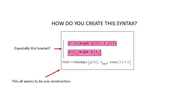

#12 Posted: 2/18/2025 9:58:02 AM
RegRetired
RegRetired
Alvaro,
Two things;
1. How do you create this syntax for Rkadapt.
2. Your integral over tk is equal to my Y as far as I can tell.
CO2 FORCING SATURATION STUDY NEW.sm (599.66 KiB) downloaded 1878 time(s).
I have tried numerous things, but I still don't understand the difference in the two methods.
Thanks much.
Reg

#14 Posted: 2/19/2025 12:17:46 AM
... 1. How do you create this syntax for Rkadapt. ...
It is the syntax for an ode solver using the "Mathcad toolbox"
