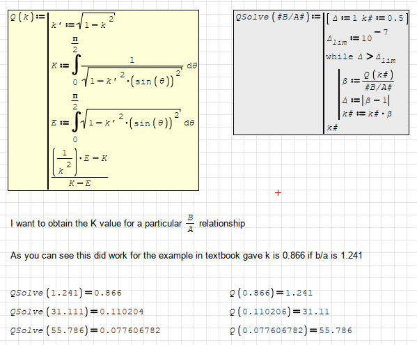

Good day everyone,
I am building a Hertzian stress calculator and got stuck at the step where I calculate the k value for a particular B/A reationship.
Any help will be appriciated
contact stress calc.sm (22.69 KiB) downloaded 693 time(s).

We also know than K will always be in the range (0,1)
The equations presented above is obtained from the book Advanced Mechanics of Materials by Boresi Et al

#6 Posted: 2022/10/24 09:26:26
1,532 likes in 1,838 posts.
With elliptic integrals from GSL and Cephes library.
Click to enlarge Click to enlarge
Alvaro 2022/10/26 14:25:00, Oscar Campo 2022/10/24 11:14:00, sergio 2022/10/25 14:02:00

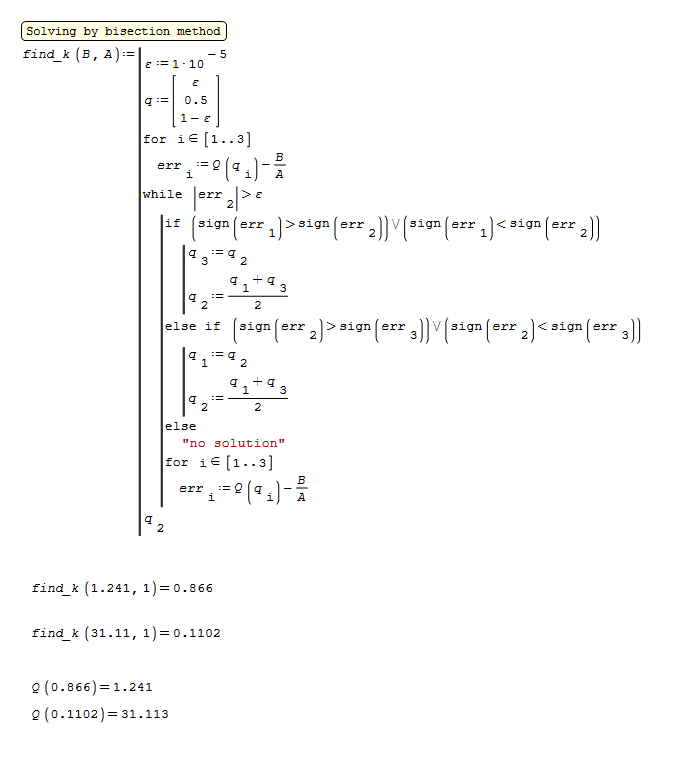

#7 Posted: 2022/10/24 20:29:42
Oscar Campo
Oscar Campo
135 likes in 309 posts.
Good day everyone,
Solving by the old bisection method:
contact stress calc_by_bisection.sm (26.36 KiB) downloaded 707 time(s).
sergio 2022/10/25 14:02:00, Alvaro 2022/10/26 14:25:00
