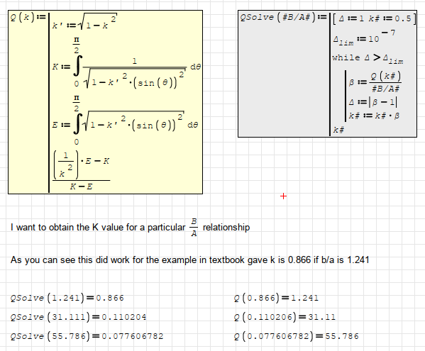

I am building a Hertzian stress calculator and got stuck at the step where I calculate the k value for a particular B/A reationship.
Any help will be appriciated
contact stress calc.sm (22.69 KiB) downloaded 1249 time(s).

We also know than K will always be in the range (0,1)
The equations presented above is obtained from the book Advanced Mechanics of Materials by Boresi Et al

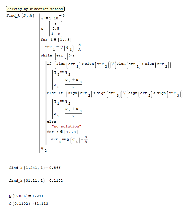

Good day everyone,
Solving by the old bisection method:
contact stress calc_by_bisection.sm (26.36 KiB) downloaded 1258 time(s).
sergio 10/25/2022 2:02:00 PM, Alvaro 10/26/2022 2:25:00 PM

#10 Posted: 10/28/2022 8:38:03 AM
... slightly refreshed/augmented
Absent of comments from Originator !
Cheers ... Jean.
Solve Circular Elliptic Datum Native Copy.sm (68.97 KiB) downloaded 1325 time(s).
