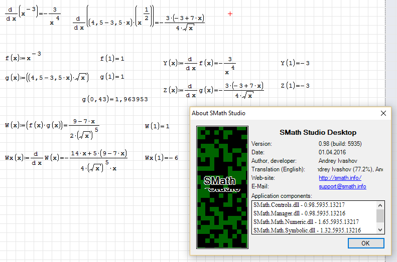

In the new version of Smath Studio ( 0.98 5935 ) , the "diff" function does not work properly, and gives the following error : diff () function is not defined.

#7 Posted: 2016/4/6 01:29:08

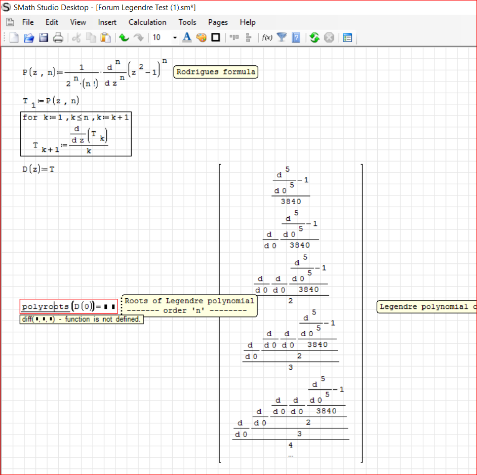

Jeand Giraud:
Your "Forum Legendre Test.sm", file does not work correctly in the current version of SMath Studio that I have installed.

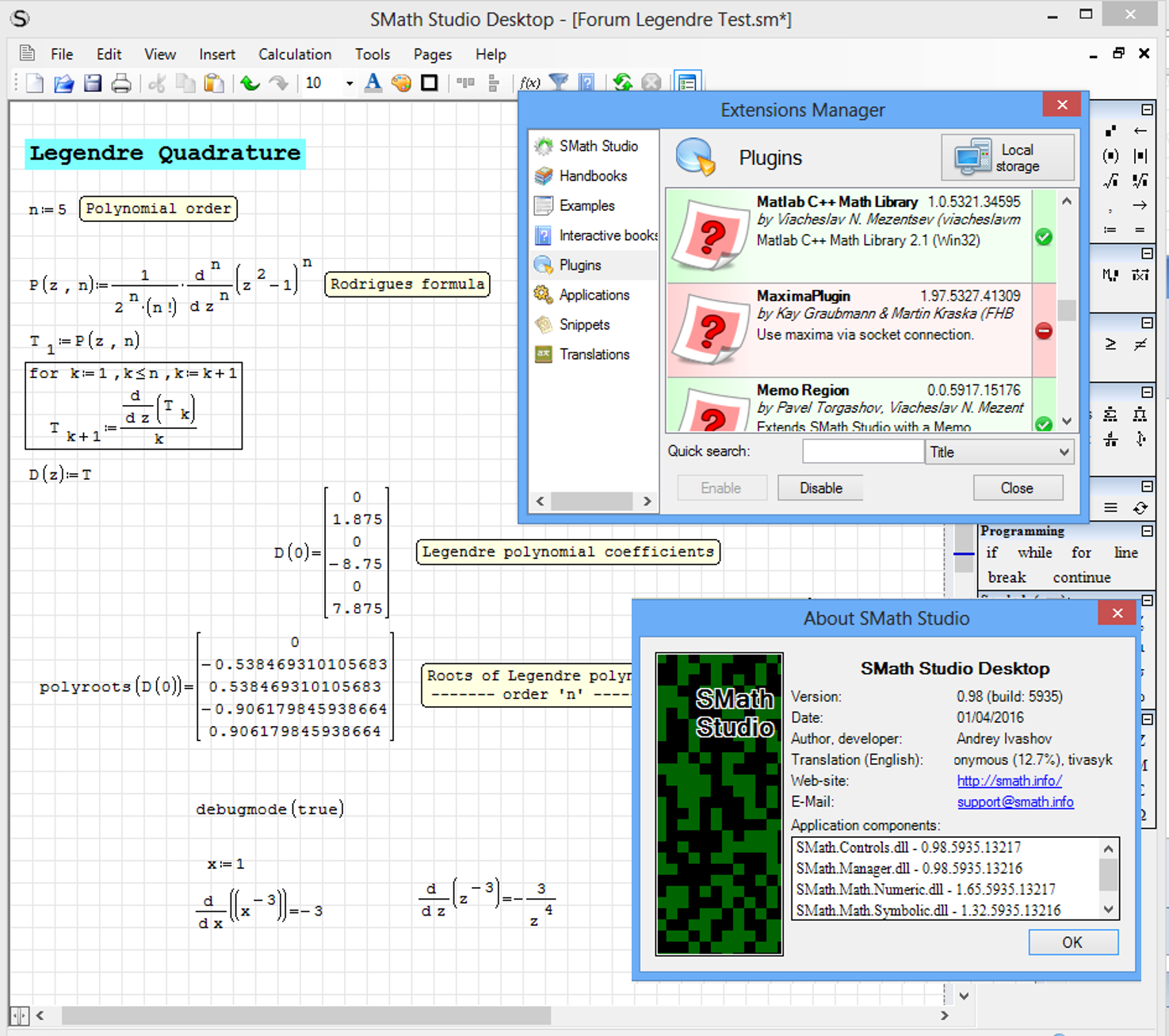

#14 Posted: 2016/4/6 13:03:46
NDTM Amarasekera
NDTM Amarasekera
130 likes in 352 posts.
It works for me in SS 98.5935.
#15 Posted: 2016/4/6 13:04:08

#18 Posted: 2016/4/6 13:51:27
NDTM Amarasekera
NDTM Amarasekera
Hi Jean,
Thanks.
The culprit is the Maxima plugin. We have to delete this plug in to get your program to run correctly.
If the plugin is disabled and then re-calculated, the program will run correct.
However, disabling is not effective, as the error will re-appear when the program is reloaded.
The error is reproduced below.
Andrey Ivashov 2016/4/6 14:16:00, Fridel Selitsky 2016/4/6 14:19:00, sergio 2016/4/6 16:07:00
