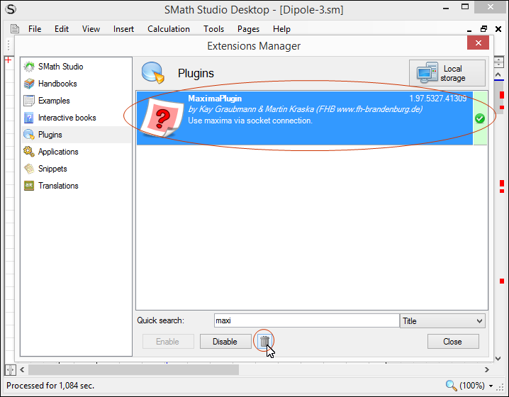

Как уже выше написали, проблема в плагине Maxima - просто удалите его и ваш расчёт снова заработает.
(ENG: As already mentioned above issue is in the Maxima plug-in - just remove it to restore your worksheet.)

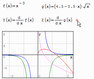

You show the plotting arguments Y(x), Z(x) but not plotted.
Is it because they don't plot at home ? Just puzzling.
#23 Posted: 2016/4/8 15:17:27
... Ah ! the plot forum was deleted.

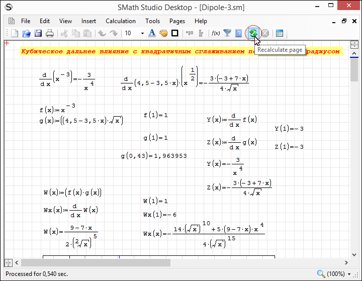

Ни один русский , это не перевод Google .
Зонд ваш файл Диполь -3.sm и Maxima плагин включен , отключить плагин , я закрыл файл , и я открыл ее , и она прекрасно работает
No Russian, this is a translation of Google .
Probe your file Dipole -3.sm and Maxima plugin is enabled , disable the plugin, I closed the file, and I opened it , and it works perfectly

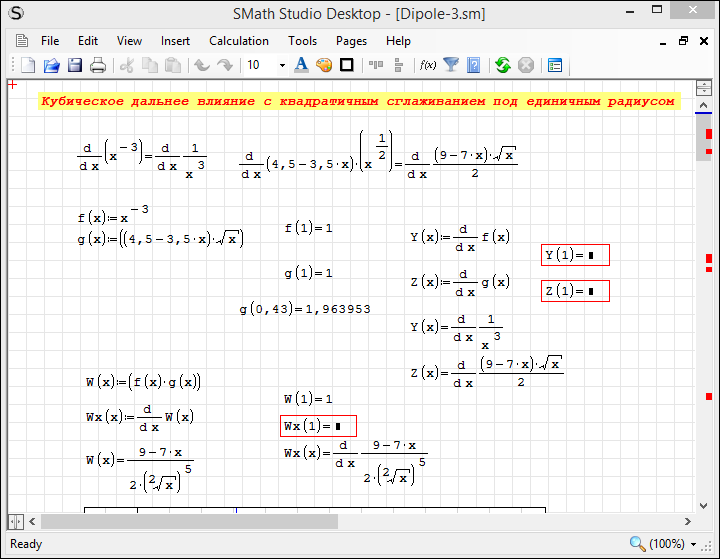

Starting at least with RC1 of 0.98 (didn't check earlier versions so far) there is a problem with the Maxima plugin breaking the built-in diff function.
I filed a bug report BTS 2311
Seems that the api changes require rework of the plugin. Unfortunately, this won't happpen soon, as it requires me to learn C# and to dig into the code. Feel free to add examples to the bug report. One day this might help with fixing the bug.
A workaround is to take over the diff function by maxima using MaximaTakeover("all" ), but I also had to add a line operator to the function definition in the example in the bug report.
Andrey, any chance to get along with the plugin as it is?
For now, the problems seem to be limited to the diff function, the remainder of "Plugin Maxima Test.sm" in the interactive handbook seems to run.
