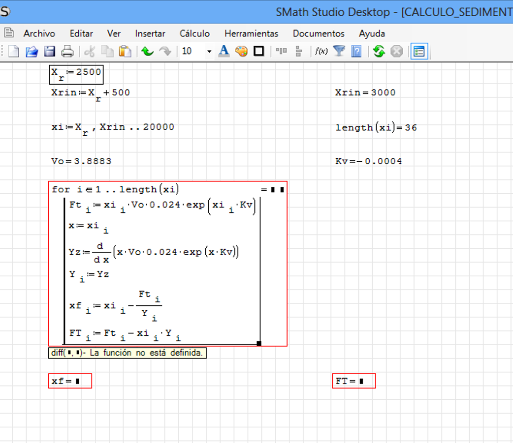

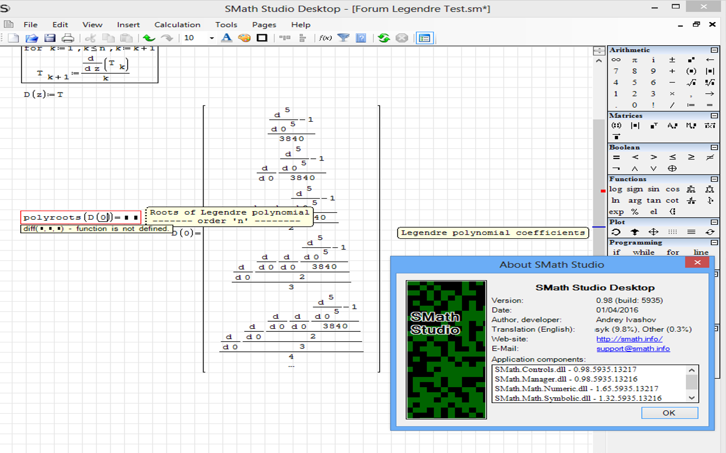

In the new version of Smath Studio ( 0.98 5935 ) , the "diff" function does not work properly, and gives the following error : diff () function is not defined.
WroteIn the new version of Smath Studio ( 0.98 5935 ) , the "diff" function does not work properly, and gives the following error : diff () function is not defined.

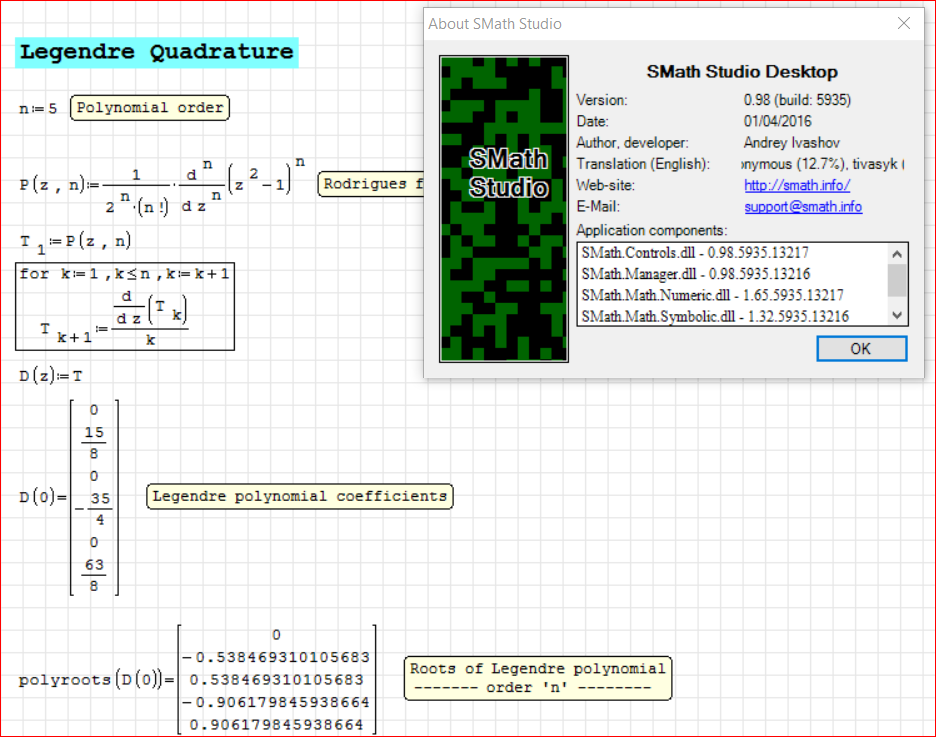

WroteThis worked very well with the previous version of
Smath Studio with the same plugins that I have installed.
Try other style 'diff'
Forum Legendre Test.sm (8,66 КиБ) скачан 1396 раз(а).

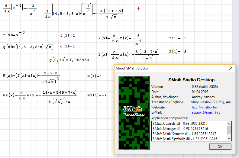

I confirm. I already wrote about it

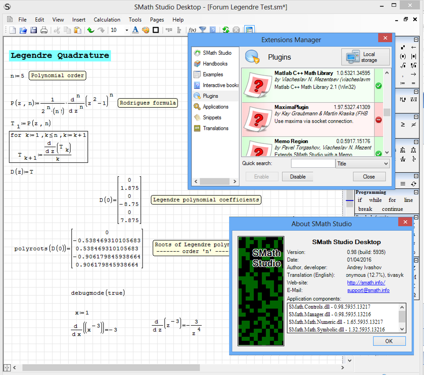

Davide Carpi 10.05.2016 06:48:00
mikekaganki : I disable all plugins, and the problem persists .
It seems to be a bug in the new version

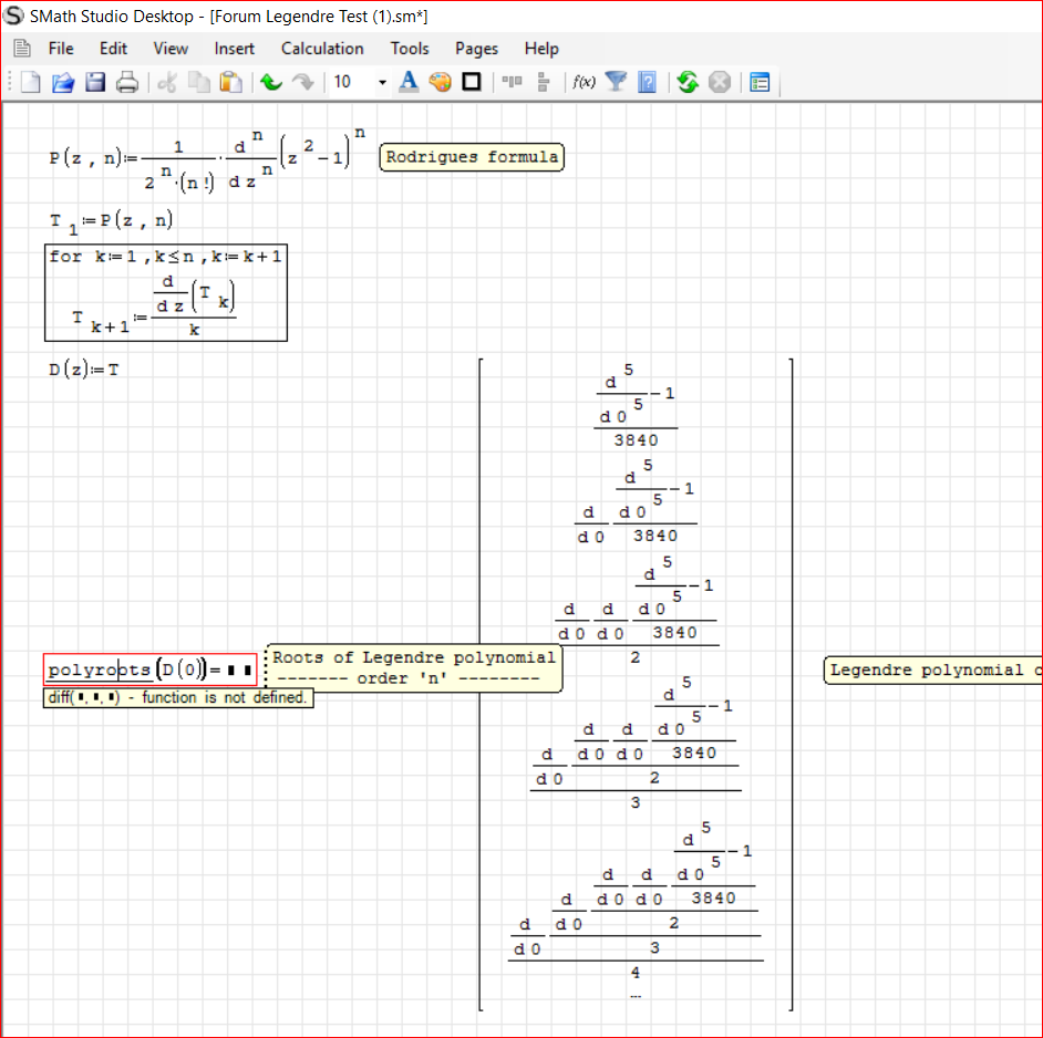

WroteYour "Forum Legendre Test.sm", file does not work correctly in the current version of SMath Studio that I have installed.
Thanks "CBG" for reporting. In Smath 5346 it does not go further than order 5,
it might ... but next century ! I was wise to tabulate "wr" the wi & roots.
So you can experiment. I have it otherwise from Mathcad but Smath does not
directly extract the coefficients for polyroots. If you are interested, in
that stuff, please let me know and see how we can collaborate.

Hi Jean,
Thanks.
The culprit is the Maxima plugin. We have to delete this plug in to get your program to run correctly.
If the plugin is disabled and then re-calculated, the program will run correct.
However, disabling is not effective, as the error will re-appear when the program is reloaded.
The error is reproduced below.
Thanks.
