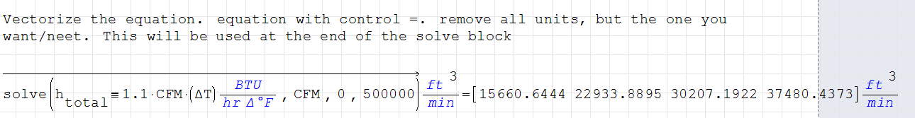

I'm not sure why would you need the solve() when you may directly calculate the result as you did,
but here it goes Solve Block.sm (7.95 KiB) downloaded 1047 time(s).
solve() cannot find units, so you need to "help" it allowing it to search for unitless values and adding required units by hands. Also, it cannot search matrices - so iterate it (I used vectorize() ).
Third - you need to pay attention when you use assignments, and when - comparisons. You happened to use := in solve() instead of ≡.
Fourth - solve(#,#) searches inside the range that is set in program's settings - use solve(#,#,#,#) to define custom range

I want to add to Davide's excellent explanation.
It's not always good to set solve range (in settings, or in solve(4) ) to very large size, because it may lead to inability to find roots, or poor precision.
solve() first splits the range to 100 even pieces and evaluates the expression for each point (excluding high edge, btw). You may see this if you try solve(x≡x;x) for default range, or similar with solve(4). After that, slove analyzes the data, using limited number of iterations. So, for very large range, no points may help it to find roots, or too many iterations may be required, so no results may be returned.
