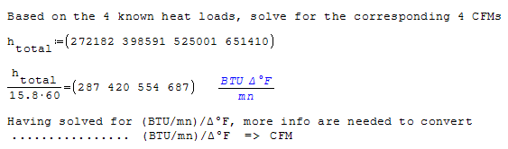

Before applying some suite, you must have something to process.
With only two temp. BTU means nothing. Two values are missing.
With the two you provide: who knows to what BTU rate they apply ?

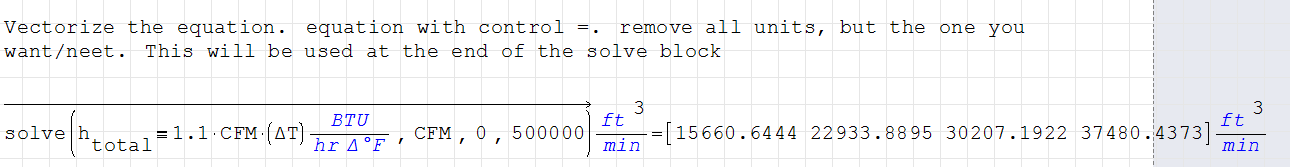

Maybe like this ?

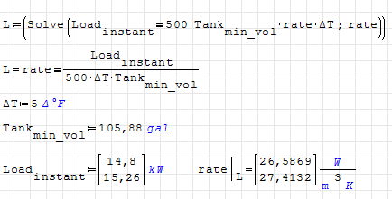

I'm not sure why would you need the solve() when you may directly calculate the result as you did,
but here it goes Solve Block.sm (7.95 KiB) downloaded 1204 time(s).
solve() cannot find units, so you need to "help" it allowing it to search for unitless values and adding required units by hands. Also, it cannot search matrices - so iterate it (I used vectorize() ).
Third - you need to pay attention when you use assignments, and when - comparisons. You happened to use := in solve() instead of ≡.
Fourth - solve(#,#) searches inside the range that is set in program's settings - use solve(#,#,#,#) to define custom range
I like documenting and showing the empirical equations for others to "see", whenever possible. Yes, easy for me to re-arrange, put I wanted to keep the look of the empirical equations when possible. This is one for Jean and his units argument.

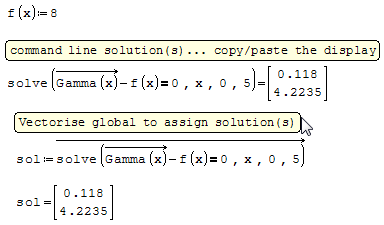

The solve block is not compatible for assigning objects that are vectorized.
This was first noticed solving Gamma(x), that solves un-assigned.
erf(x), Gamma(x) are two reported, that solve from vectorising, not assignable.
Nothing to do => copy/pate ... Does not spool to file either

Any recommendations?For now, I will do copy and paste, but I would like to "automate" the solution since these numbers are used downstream.I'm not seeing a programmed solve program, unless there is an example I missed in the forum.
You have missed nothing from the forum, has never bee exemplified.
I don't work with units, sorry for your work sheet.
As explained before => Gamma(x) is one that needs be vectorised locally
That does not exclude global vectorising for further use, downstream the document.
Cheers Esild ... Jean

That' the best I can do.
1. Subscript should not exist [complicate matters].
2. What are "Units" doing in Engineering works ?
solve block 2 Examine Solutions.sm (7.26 KiB) downloaded 1143 time(s).

mkrask,
maybe it's my misunderstanding and lack of familiarity with the Maple plugin
Jean,
Finally, an example that shows WHY we need units the items in the array are in kW and need to be in BTU/hr for the empiracle equation to be valid. If I split the array like you did, it does what i need ... wondering why I cannot do it with vectorize Solve Block 2a.smz (4.41 KiB) downloaded 1227 time(s).
