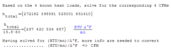

#4 Опубликовано: 18.04.2016 17:22:30
Maybe like this ?

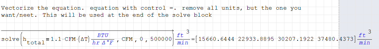

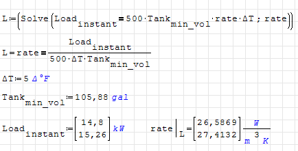

#13 Опубликовано: 03.08.2017 16:19:33
Solve() from the Maxima plugin
solve%20block%202.sm (4,91 КиБ) скачан 1250 раз(а).
#14 Опубликовано: 03.08.2017 17:04:27
Ruben Sidranski
Ruben Sidranski
mkraska - Thank you, but not what I was looking for. I have the power already calculated/known ... I am looking to solve for a rate of time. As you can see in my example, the program will solve as long as I do NOT define the solve block with a variable. It also looks like you are using the Maple plugin.
Update, I thought that Vectorize eliminated the nesting issue. I think that is what is going on as my solution may be a nested item and not a matrix. Definitely a nesting issue. How do I "un-nest" a Vectorized equation? Solve Block 2.smz (2,87 КиБ) скачан 1227 раз(а).without jMG Matrix manipulation. I was hoping Vectorize would simplify the issue.

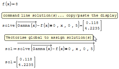

#15 Опубликовано: 04.08.2017 10:55:57
The solve block is not compatible for assigning objects that are vectorized.
This was first noticed solving Gamma(x), that solves un-assigned.
erf(x), Gamma(x) are two reported, that solve from vectorising, not assignable.
Nothing to do => copy/pate ... Does not spool to file either
ElSid 04.08.2017 14:50:00

#18 Опубликовано: 04.08.2017 21:29:59
Any recommendations?For now, I will do copy and paste, but I would like to "automate" the solution since these numbers are used downstream.I'm not seeing a programmed solve program, unless there is an example I missed in the forum.
You have missed nothing from the forum, has never bee exemplified.
I don't work with units, sorry for your work sheet.
As explained before => Gamma(x) is one that needs be vectorised locally
That does not exclude global vectorising for further use, downstream the document.
Cheers Esild ... Jean
#19 Опубликовано: 04.08.2017 22:29:03
That' the best I can do.
1. Subscript should not exist [complicate matters].
2. What are "Units" doing in Engineering works ?
solve block 2 Examine Solutions.sm (7,26 КиБ) скачан 1143 раз(а).
