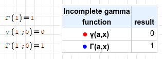

Sanity checked vs Mathcad 11.
Cuts the mustard a bit finer than first version.
Γ(1,0)="Uncertainty" unsolved.
#22 Posted: 2021/6/11 14:56:09
598 likes in 1,380 posts.
There is no uncertainty in gamma_r6.
Everything look correct with those numbers.
Γ(1)=1
γ(1,0)=0
Γ(1,0)=1
#23 Posted: 2021/6/11 16:33:56
1. Example 3 ... added
2. Uncertainty solved for version not having 0 defined.
Gamma [overlord sr.6].sm (39.32 KiB) downloaded 1009 time(s).

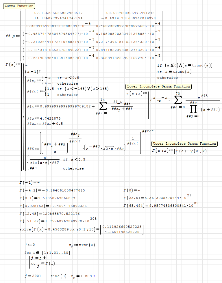

Thanks, inspired by your code using sum(), and eliminating some useless variable definitions;
I have managed to speed up 30% percent under linux. And should be more precise now.
Only the 15th decimal digit may differs, and this is only sometimes.
Regards.

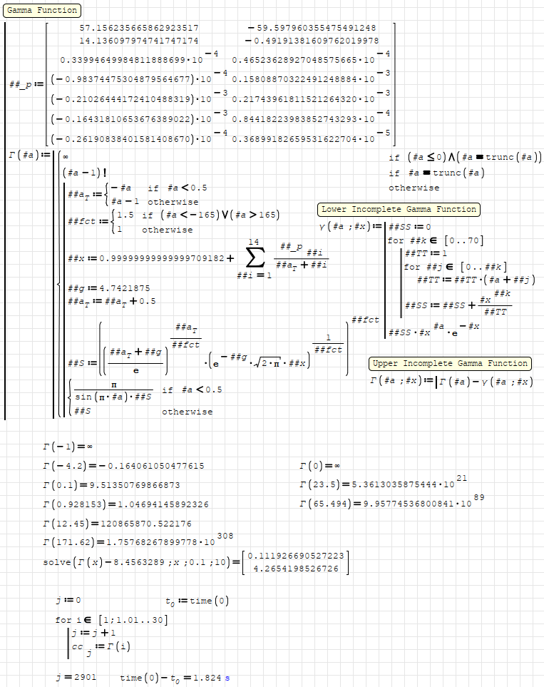

gamma_r7.sm (28.8 KiB) downloaded 1333 time(s).
#26 Posted: 2021/6/12 14:58:22
Apparently solve() can't read product() too.
Had to change algorithm style for incomplete function.
Hopefully this is the last version.
Well, I have my doubts... (swh)
PS: solvers may not found an answer just because variable names, Razonar's idea implemented.
gamma_r8.sm (29.61 KiB) downloaded 1315 time(s).
gamma_r8.sm (31.51 KiB) downloaded 1365 time(s). <---gamma_r8-2 (function variable revision)

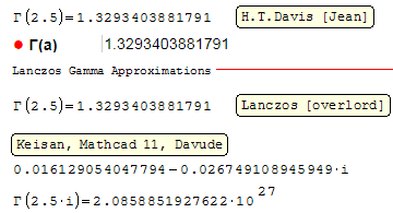

Can't be more right !
1. Smath Lanczos Davide code is 1/1 Keisan, Mathcad 11.
2. It supports imaginary argument.
3. It supports RootSecant.
4. Confirmed, your last Lanczos does not support RootSecant.
I haven't checked Alvaro suggestion.
#29 Posted: 2021/6/12 20:23:36
... just a remark:
Mathsoft suggested use exp(,) instead of e^.
exp(,) more accurate/faster at kernel level.

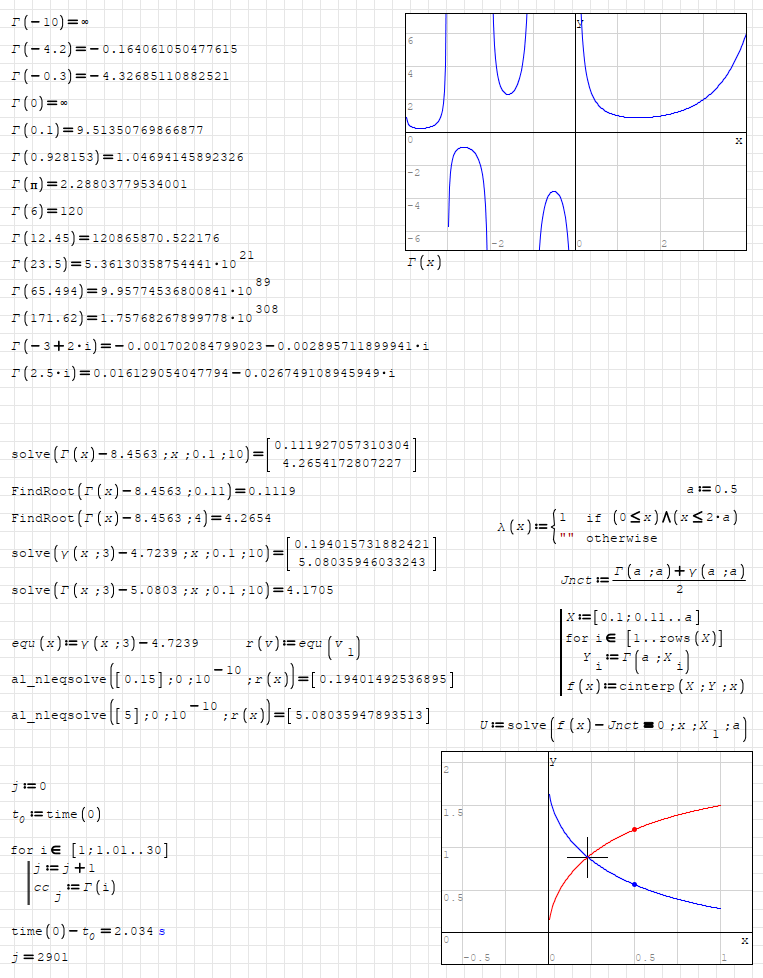

#30 Posted: 2021/6/13 01:26:31
Imaginary numbers supplicated.
Root Secant better than HT Davis. (last digit)
Graphing works for all functions.
Usually all solve methods works.
gamma_r9.sm (36.93 KiB) downloaded 1690 time(s).

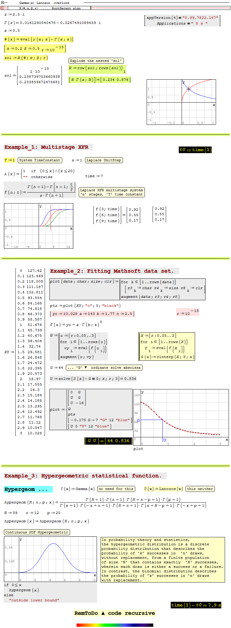

#32 Posted: 2021/6/13 15:26:22
Your latest sr.9 is mostly red in SS 6179, takes Eternity.
Who cares ^308 ?
On the other hand, could be damned slow in practical applications.
Because not being built-in in native Smath ... proof:
Lanczos plots Hypergeometric but takes 1 min versus resident Gamma(x).
Why not use Lanczos as given by Davide ?
- Who cares SMath 6179?
- My algorithm is faster than your examples.
- My Γ(x) prints hypergeom in less than a second, don't need integrated Gamma().
- Because my function has more features, and faster.
Your PC is slow, your SMath_6179 is slow and broken, your examples are slow.
Gamma [H.T. Davis, Lanczos_overlord].sm (62.36 KiB) downloaded 1188 time(s).
Gamma [H.T. Davis, Lanczos_overlord].pdf (155.73 KiB) downloaded 652 time(s).
