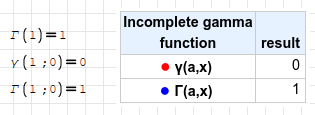

Sanity checked vs Mathcad 11.
Cuts the mustard a bit finer than first version.
Γ(1,0)="Uncertainty" unsolved.
#22 Опубликовано: 11.06.2021 14:56:09
599 сообщений из 1 380 понравились пользователям.
There is no uncertainty in gamma_r6.
Everything look correct with those numbers.
Γ(1)=1
γ(1,0)=0
Γ(1,0)=1
#23 Опубликовано: 11.06.2021 16:33:56
1. Example 3 ... added
2. Uncertainty solved for version not having 0 defined.

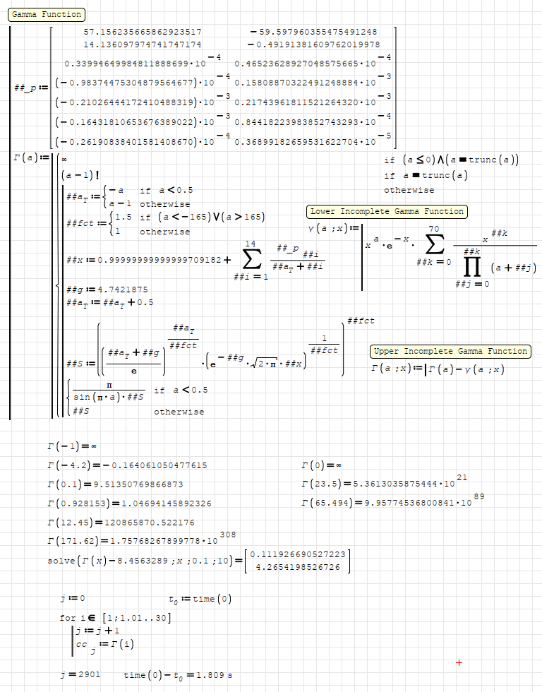

#26 Опубликовано: 12.06.2021 14:58:22
Apparently solve() can't read product() too.
Had to change algorithm style for incomplete function.
Hopefully this is the last version.
Well, I have my doubts... (swh)
PS: solvers may not found an answer just because variable names, Razonar's idea implemented.
gamma_r8.sm (29,61 КиБ) скачан 1462 раз(а).
gamma_r8.sm (31,51 КиБ) скачан 1490 раз(а). <---gamma_r8-2 (function variable revision)

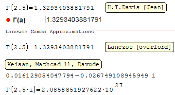

1. Smath Lanczos Davide code is 1/1 Keisan, Mathcad 11.
2. It supports imaginary argument.
3. It supports RootSecant.
4. Confirmed, your last Lanczos does not support RootSecant.
I haven't checked Alvaro suggestion.

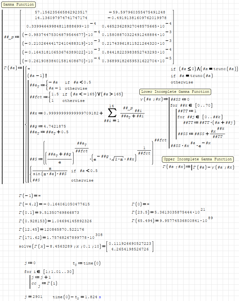

... just a remark:
Mathsoft suggested use exp(,) instead of e^.
exp(,) more accurate/faster at kernel level.

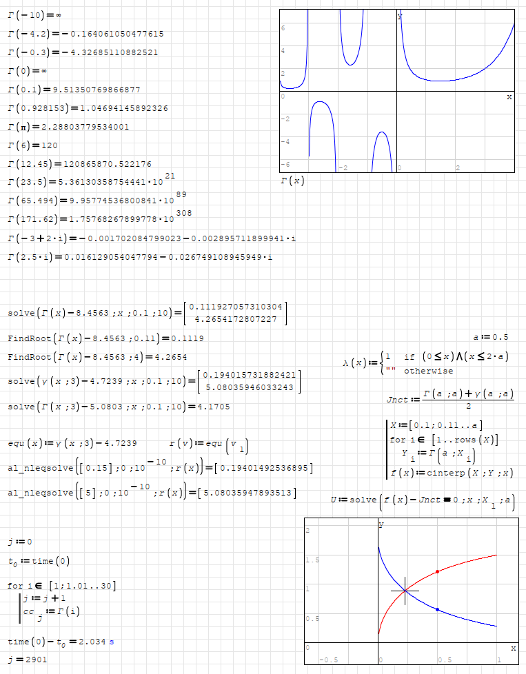

#30 Опубликовано: 13.06.2021 01:26:31
Imaginary numbers supplicated.
Root Secant better than HT Davis. (last digit)
Graphing works for all functions.
Usually all solve methods works.
gamma_r9.sm (36,93 КиБ) скачан 1874 раз(а).

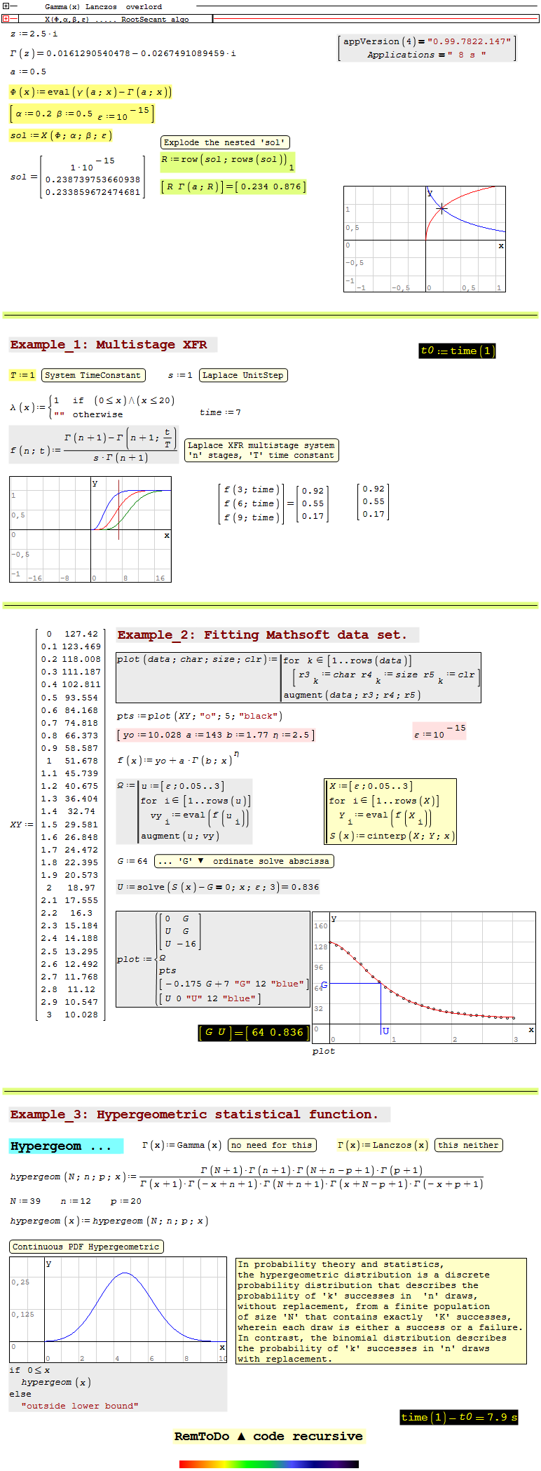

#32 Опубликовано: 13.06.2021 15:26:22
Your latest sr.9 is mostly red in SS 6179, takes Eternity.
Who cares ^308 ?
On the other hand, could be damned slow in practical applications.
Because not being built-in in native Smath ... proof:
Lanczos plots Hypergeometric but takes 1 min versus resident Gamma(x).
Why not use Lanczos as given by Davide ?
- Who cares SMath 6179?
- My algorithm is faster than your examples.
- My Γ(x) prints hypergeom in less than a second, don't need integrated Gamma().
- Because my function has more features, and faster.
Your PC is slow, your SMath_6179 is slow and broken, your examples are slow.
Gamma [H.T. Davis, Lanczos_overlord].sm (62,36 КиБ) скачан 1343 раз(а).
Gamma [H.T. Davis, Lanczos_overlord].pdf (155,73 КиБ) скачан 761 раз(а).
