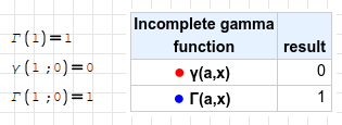

Γ(1,0)="Uncertainty" unsolved.
#22 Posted: 6/11/2021 2:56:09 PM
600 likes in 1,381 posts.
Sanity checked vs Mathcad 11.
Cuts the mustard a bit finer than first version.
There is no uncertainty in gamma_r6.
Everything look correct with those numbers.
Γ(1)=1
γ(1,0)=0
Γ(1,0)=1

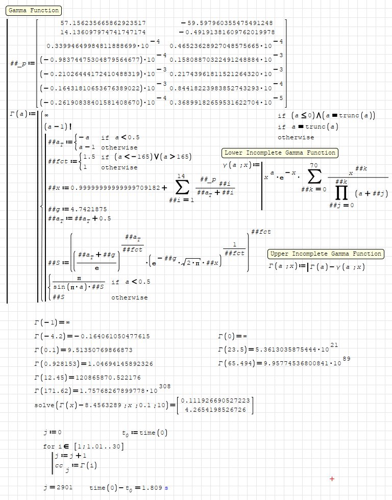

Thanks, inspired by your code using sum(), and eliminating some useless variable definitions;
I have managed to speed up 30% percent under linux. And should be more precise now.
Only the 15th decimal digit may differs, and this is only sometimes.
Regards.
gamma_r7.sm (28.8 KiB) downloaded 1504 time(s).
#26 Posted: 6/12/2021 2:58:22 PM

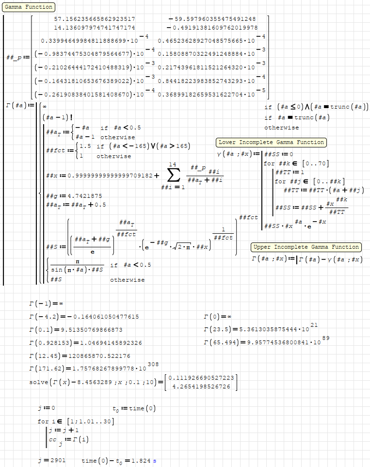

Apparently solve() can't read product() too.
Had to change algorithm style for incomplete function.
Hopefully this is the last version.
Well, I have my doubts... (swh)
PS: solvers may not found an answer just because variable names, Razonar's idea implemented.
gamma_r8.sm (29.61 KiB) downloaded 1506 time(s).

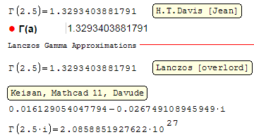

1. Smath Lanczos Davide code is 1/1 Keisan, Mathcad 11.
2. It supports imaginary argument.
3. It supports RootSecant.
4. Confirmed, your last Lanczos does not support RootSecant.

- Who cares SMath 6179?
- My algorithm is faster than your examples.
- My Γ(x) prints hypergeom in less than a second, don't need integrated Gamma().
- Because my function has more features, and faster.
Your PC is slow, your SMath_6179 is slow and broken, your examples are slow.
