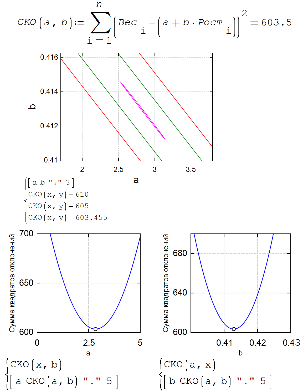

I have two 2D plots, but not one 3D plot with the minimum point.
Help please!

Thanks, but better so - a counter plot
6-1-Mister-Class.sm (30.03 KiB) downloaded 1170 time(s).

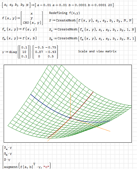

Hi. Choosing CKO as z and using small ranges.
6-1-Mister-Class 3D.sm (41.91 KiB) downloaded 1201 time(s).
