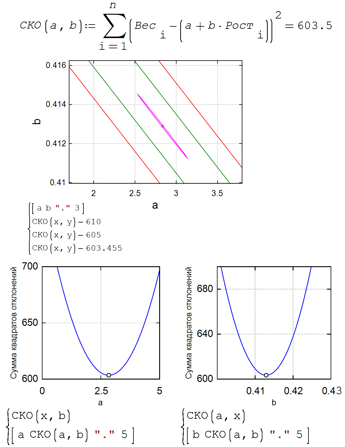

I have two 2D plots, but not one 3D plot with the minimum point.
Help please!

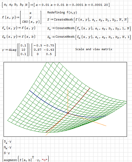

Hi Valery. This is a way.
6-1-Mister-Class.sm (27,39 КиБ) скачан 1255 раз(а).

Thanks, but better so - a counter plot
6-1-Mister-Class.sm (30,03 КиБ) скачан 1236 раз(а).

Hi. Choosing CKO as z and using small ranges.
6-1-Mister-Class 3D.sm (41,91 КиБ) скачан 1270 раз(а).
