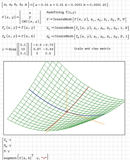

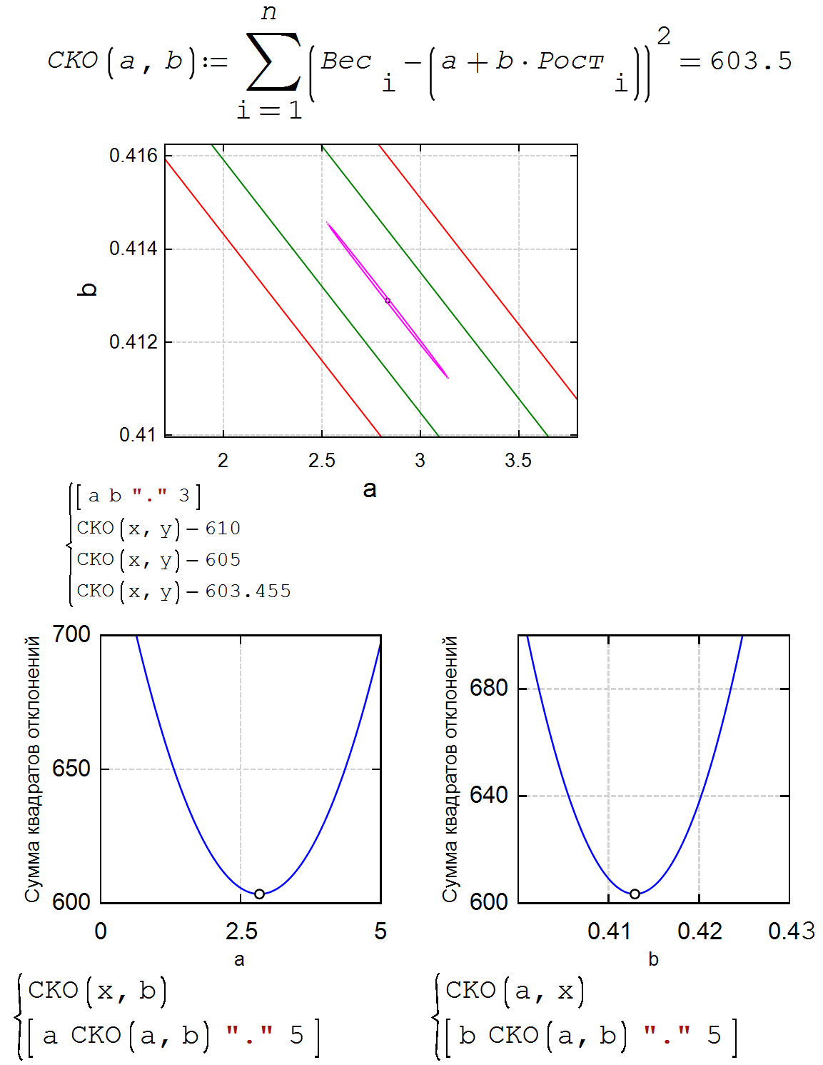

I have two 2D plots, but not one 3D plot with the minimum point.
Help please!

Hi Valery. This is a way.
6-1-Mister-Class.sm (27.39 KiB) downloaded 1370 time(s).

Thanks, but better so - a counter plot
6-1-Mister-Class.sm (30.03 KiB) downloaded 1349 time(s).

Hi. Choosing CKO as z and using small ranges.
6-1-Mister-Class 3D.sm (41.91 KiB) downloaded 1384 time(s).
