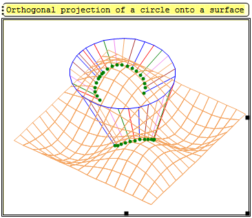

Distance and projection of a point onto a parametric surface
ParSur.sm (74.98 KiB) downloaded 1639 time(s).
ParSur.pdf (619.79 KiB) downloaded 982 time(s).
Projection of a curve onto a surface
Computing the projection of a point onto a surface is to find a closest point
on the surface, and projection of a curve onto a surface is the locus of all
points on the curve project onto the surface.
projection.sm (22.03 KiB) downloaded 1475 time(s).
projectionB.sm (34.01 KiB) downloaded 1501 time(s).
Alvaro 2021/4/18 14:35:00, Andrey Ivashov 2021/4/18 16:03:00

Remarks:
1,Unlike the previous examples, the last file does not use dragilev's method.
2.Bar structure analogy.A heavy hoop is pivotally attached to weightless rods
that rest on an uneven surface.The slope of each bar coincides with the surface
ormal at the foothold point. Consequently, the rods perceive only normal (compressive) load.

Hi Ber. As usual, your samples are amazing.
It could be interesting convert it to Dragilev's method. I don't have enough time right now.
Oh! I try to understand that, but can take a while. Well, I understand now why it could be important. In the mean time, here a faster version, with some margin notes.
projection.sm (62.32 KiB) downloaded 1534 time(s).
projection.pdf (840.02 KiB) downloaded 987 time(s).
Fridel Selitsky 2021/4/20 08:12:00

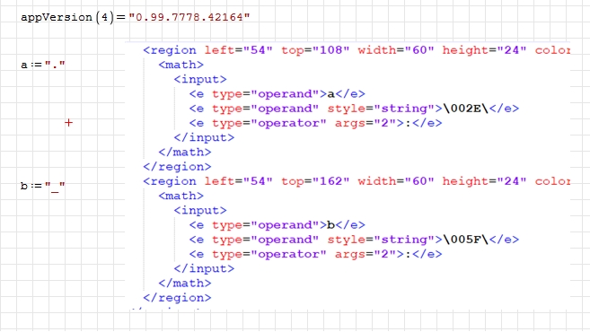

IHi,Alvaro .In my version 0.99.7610 green dots are displayed
as unicode characters.Until I understand what is the reason.
Fridel.
#95 Posted: 2021/4/25 13:46:25
1,123 likes in 1,795 posts.
Fridel.
Hi Friedel. Nice, you're looking the matrix as hexadecimal. It could be better than reading it in binary, like in the movie. That, or this bug:
test.sm (2.5 KiB) downloaded 1560 time(s).
Fridel Selitsky 2021/4/25 14:40:00

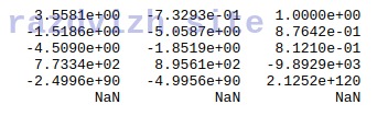

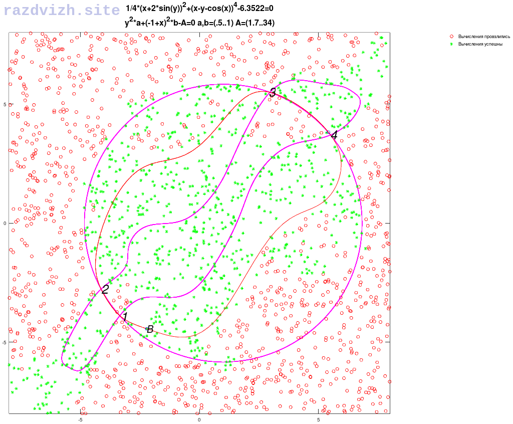

Метод чувствителен к выбору начального положения. Существуют области устойчивости и неустойчивости. Области зависят от выбранной точности. Не все координаты из областей устойчивости дают все решения при смене знака у дополнительно введенного параметра.
[ENG]
The method is sensitive to the choice of initial position. There are regions of stability and instability. The regions depend on the chosen accuracy. Not all coordinates from the regions of stability give all solutions when the sign of the additionally introduced parameter changes.
На рис. pol1 представлены две кривые и точки. Красным и зеленым цветом показаны точки начального положения для расчета пересечения по методу Драгилева. Красный цвет означает, что в результате решения значение достигли Nan (т.е. бесконечности); зеленый, что решения не достигли Nan. На рис. pol2 представлено для красной точки А расчеты с достижением Nan.
[ENG]
Figure pol1 shows the two curves and points. Red and green show the initial position points for calculating the intersection by the Dragilev method. Red indicates that the solutions reached Nan (i.e., infinity); green indicates that the solutions did not reach Nan. Figure pol2 shows for red point A the calculations with reaching Nan.
На рис. pol3 представлены три кривые и точки. Третья кривая построена через зеленую точку B. Видно что она пересекает две начальные кривые в точках пересечения 1,2,3,4
[ENG]
Figure pol3 shows three curves and points. The third curve is drawn through the green point B. You can see that it intersects the two initial curves at the intersection points 1,2,3,4
На анимации представлено изменение кривой 2 и области устойчивости и неустойчивости
[ENG]
The animation shows the change of curve 2 and the region of stability and instability
pol.avi (3.81 MiB) downloaded 507 time(s).
