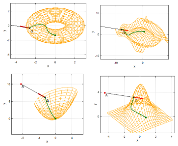

Finding Distance of a Point from Surface
The difference from the program distance to the curve in only one expression:
in the top line instead of i: = (1 ... 2)) we have i: = (1 ... 3).
A is a given point, a is its projection to the surface, Аa (k) is the length of the segment Аa (k)
to the surface, the h-step of decreasing the distance, a (k) is the intermediate coordinate of
the point touch.The red line is the normal, the green is the trajectory of the movement of the
point a (k) from the initial the position of a (1) to the final a.I borrowed the trajectory
demonstration from Razonar,to whom I express my gratitude.
Dist3d.sm (63.12 KiB) downloaded 1497 time(s).
4 users liked this post

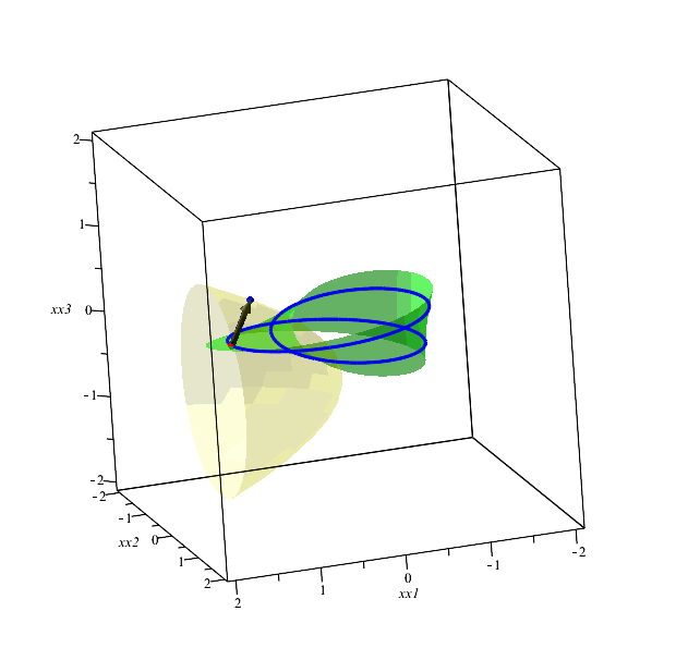

“Finding Distance of a Point from curve or surface” - not far the best application of the Draghilev method.
An example of the projection of points from one surface to another using the optimization methods in Maple.

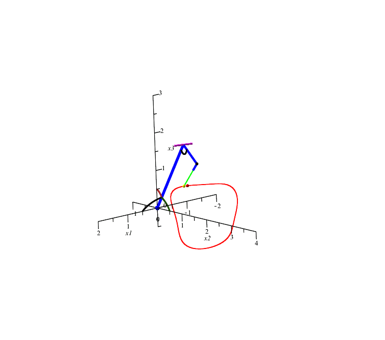

It seems to me that the Draghilev method is intended for a “large” number of variables with a “small” number of equations.
For example, as in the case of solving the inverse problem of kinematics for a three-link manipulator with a variable length of the working link. This manipulator has 6 degrees of freedom.

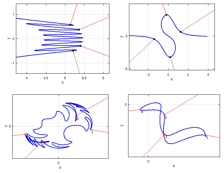

Point Orthogonal Projection onto a flat or spatial Curve
Calculation procedure
1. We will use Draghilev's method
a) to parameterizethe curves and find a good initial guess.
We will use the point a0, found by the minimum distance
from the curve to a given point P.
b) to calculate the unit vector of the tangent T (x) to a
point on the curve.
2 To the system of equations we add an equation that
expresses the conditions of perpendicularityof the tangent
at the point x of the curve and the segment connecting the
points P and x. This means that the inner product of the unit
tangent vector to the curve f (x) and the unit vector Px is
equal to zero. As a result, we obtain the system of equations
3. We solve the system with the initial assumption a0
distantion.sm (124.14 KiB) downloaded 1527 time(s).
Trascidental curves.pdf (394.93 KiB) downloaded 865 time(s).
NDTM Amarasekera 2020/10/3 12:08:00, Davide Carpi 2020/10/2 16:26:00, Andrey Ivashov 2020/10/2 17:25:00

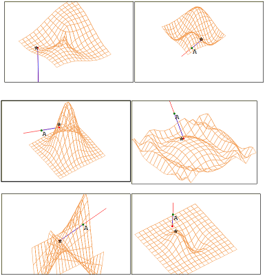

Distance and projection of a point onto a parametric surface
ParSur.sm (74.98 KiB) downloaded 1639 time(s).
ParSur.pdf (619.79 KiB) downloaded 982 time(s).
Alvaro 2020/12/2 18:21:00
