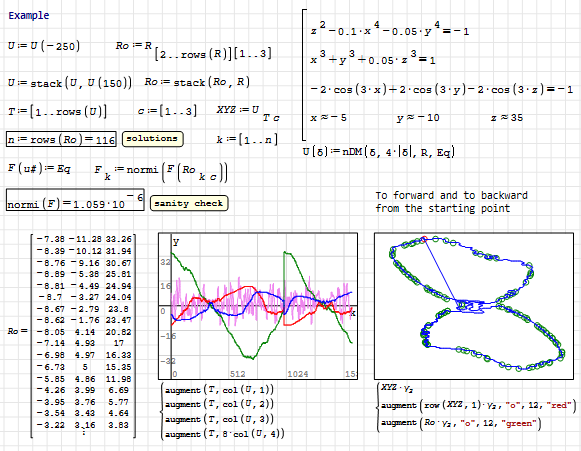

#122 Posted: 2024/3/2 20:17:31
1,123 likes in 1,795 posts.
40 solutions can be found
Hello Alvaro! Yes, thanks for the work done. This was, one might say, a test example for the Method. This system of equations has 116 solutions. The first two equations describe a closed curve; moving along it, we track the change in the sign of the last equation. There are 116 solutions in total.
The 116 solutions.
DraghilevSolveBlock - alexey 116 example.sm (275.71 KiB) downloaded 1539 time(s).
There is also an old example. This system reflects a real physical process. As far as I remember, it is connected with electricity.
It would be nice to show the complete solution, or an approach to obtaining the complete solution.
1 - 2cos(x1) + 2cos(x2) - 2cos(x3) - x4 = 0;
1- 2cos(5x1) + 2cos(5x2) - 2cos(5x3) = 0;
1 - 2cos(7x1) + 2cos(7x2) - 2cos(7x3) = 0;
Do you have some other information? Like what is x4 (a parameter for making a lot of 3x3 nonlinear equations system?) Or how many solutions are, or something else.
алексей 2024/3/3 02:42:00, Вячеслав Мезенцев 2024/3/2 21:44:00

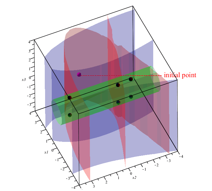

#125 Posted: 2024/3/4 00:44:02
алексей
алексей
17 likes in 78 posts.
Hello Alvaro.
I think that in this case it is not very convenient to immediately apply Draghilev’s method. I tried two ways to get the solution. One way is to work directly with the system itself, that is, add some equation to the system to get the starting point, for example x1+x2+x3+x4=0. After this, we calculate the line in R^4. This line will be one of the subsets of the system solution. The coordinates of points x1, x2, x3 with a period of 2Pi will define an infinite set of subsets with coordinate x4. By changing the additional equation, we can get an idea of the set of such subsets. They are all solutions of the system.
Since the solution is numerical, it is probably impossible to say that we have found a complete solution. But practically it is possible.
As for visualization, we can display on a graph a combination of 3 coordinates out of 4: x1,x2,x3; x1,x2,x4: x1,x3,x4; x2,x3,x4. (This produces an infinite set of closed curves.)
The second way is to reduce the original system to a system of polynomial equations by means of the following replacement
cos(x1) = x1, cos(x2) = x2, cos(x3) = x3.
1-2*x1+2*x2-2*x3-x4 = 0
-32*x1^5+32*x2^5-32*x3^5+40*x1^3-40*x2^3+40*x3^3-10*x1+10*x2-10*x3+1=0
-128*x1^7+128*x2^7-128*x3^7+224*x1^5-224*x2^5+224*x3^5-112*x1^3+112*x2^3-112*x3^3+14*x1-14*x2+14*x3+1=0
In this case, we get more opportunities to identify all the original subsets of solutions, because for any one auxiliary equation, according to the theory, all solutions are found (Gröbner bases). Then we make a reverse replacement, take into account the period, look at the graphs and, on a practical basis, assert that we have obtained a solution to the original system.
It's definitely a lot easier for me because Maple does all the work for me. Both Gröbner bases and powerful procedures for solving ODEs are implemented there. It takes literally seconds to obtain a solution in the form of a set of curves.
Another difficulty is visualizing the 3 intersecting surfaces.
Of course, because SMath does not have the corresponding functions.

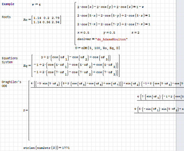

#137 Posted: 2024/3/10 04:29:30
алексей
алексей
In fact, in this case, this approach is the most reliable for identifying patterns in the location of solutions in space. I took some time and tried several types of auxiliary equations. I think, given symmetry, three main types of closed polynomial curves emerged. And therefore closed trigonometric curves with a period of 2Pi will represent the entire solution after the transition to the original variables.

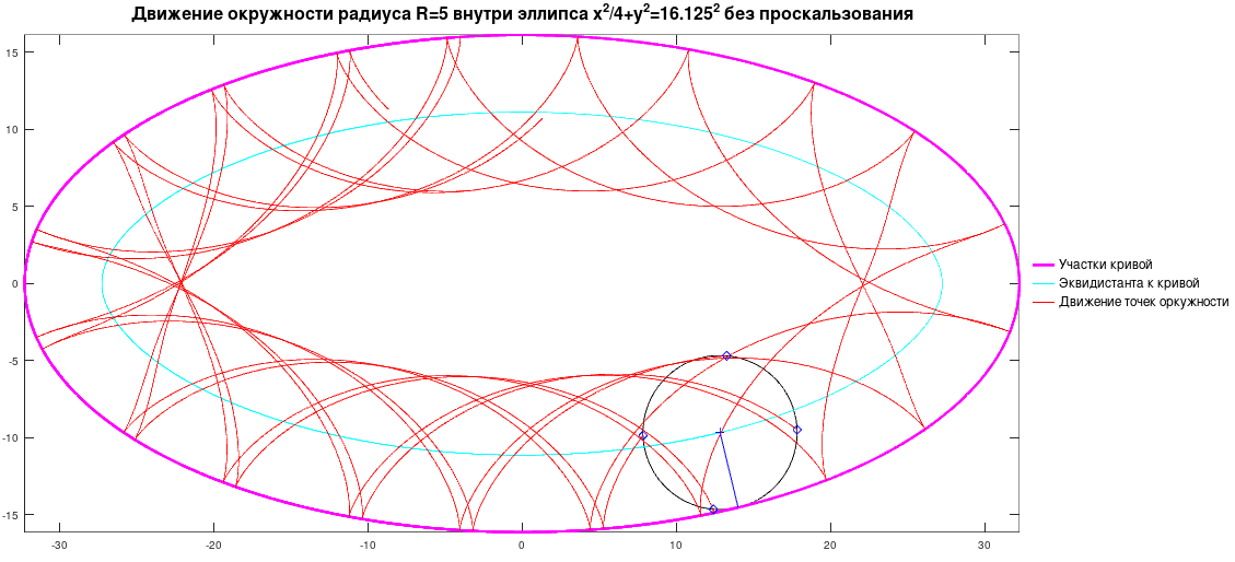

#138 Posted: 2024/3/14 12:33:27
grelkin2
grelkin2
14 likes in 66 posts.
[RUS]Движение колесика внутри эллипса с небольшим радиусом без переката и с большим радиусом с перекатом без проскальзывания. Центр колесика движется по эквидистантной кривой к эллипсу, точки на ободе движутся по циклоидным кривым.[/RUS]
[ENG]Movement of a wheel inside an ellipse with a small radius without rolling and with a large radius with rolling without slipping. The center of the wheel moves along an equidistant curve to the ellipse, the points on the rim move along cycloidal curves.[/ENG]
kol3a.mov (986.65 KiB) downloaded 300 time(s).
kol3.mov (775.09 KiB) downloaded 337 time(s).
#139 Posted: 2024/3/16 16:36:20
алексей
алексей
An example of visualization of solving a system of 3 equations with 3 variables using the Draghilev method. The system has 6 solutions. All solutions are found for one initial point.
4(x1^2 + x2 - 11)*x1 + 2x1 + 2x2^2 + 2cos(x1) - 14 = 0;
2x1^2 + 2x2 + 4(x2^2 + x1 - 7)*x2 - sin(x2) - 22 = 0;
x1^2 + x3^2 - 1 = 0;

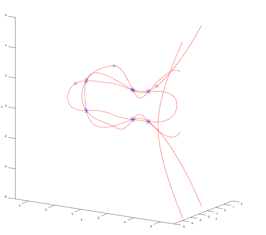

#140 Posted: 2024/3/29 03:06:44
grelkin2
grelkin2
Solutions to check out:
0.149315 2.877635 0.988708
0.149318 2.877632 -0.988825
-0.231009 -0.888544 -0.972951
-0.083331 -1.981040 -0.996530
-0.083331 -1.981024 0.996514
-0.231007 -0.888540 0.972950
Some initial points:
-3.6100e-01 3.3820e+00 8.4200e-01
-2.0000e-02 -2.5860e+00 1.4310e+00
9.5000e-01 1.2780e+00 2.0150e+00
In the figure, the solutions are shown with an asterisk, the red curves are obtained when different initial conditions are given.
