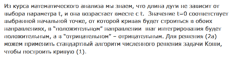

A lot. For instance, from the paper that you give as reference ( https://vk.com/doc242471809_437831729 ) can read:
"From the course of mathematical analysis, we know that the length of the arc does not depend on the choice of the parameter t, and it increases with t. The value t = 0 corresponds to the selected starting point, from which the curve will be constructed in both directions, in the “positive” direction the integration step will be positive, and in the “negative” direction - negative. To solve (2a), we can apply the standard algorithm for the numerical solution of the Cauchy problem to construct the curve (1)."
"We construct the curve (1), assuming that the length of the arc of the curve itself is the independent variable. The coordinates of the points of the curve will be obtained as a solution to the Cauchy problem for a system of ordinary differential equations, the initial data for which will be the coordinates of the previously known point belonging to this curve"
But the final parametrization isn't along the arc length.

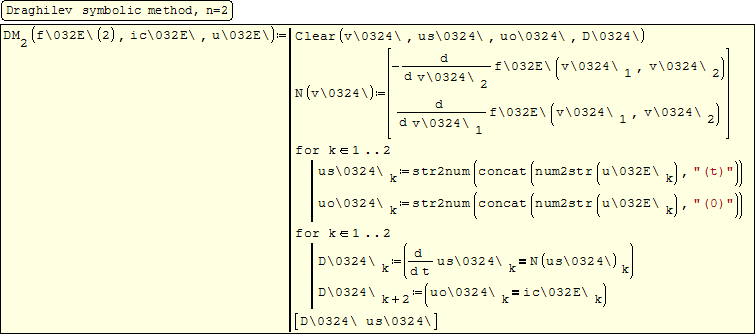

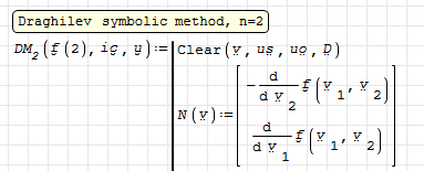

Hi Jean. What you see is the unicode code for some ornaments. I use them because I don't like the use of x#, y# ... etc for each variable in the definition and body of the SMath procedures.
Maybe you don't have the unicode version of Courier New font.
Special characters mode is available since Version 0.99.6617, hence can't be rendered correctly in Jean's 0.98.6179 (no matter what fonts he has)
Please note that decorations aren't really needed since 0.98.6325 when Clear() was made built-in and that is enough to isolate line() procedures from external variables (useful in Jean's 0.98.6179, though)
What is the meaning of your messages? Using the arc length as an independent variable is a well-known technique and is not directly related to the Draghilev method, but can be used in the implementation of the method. For example, I widely use this technique. This is achieved by simple normalization of the variable of integration by the magnitude (dx^2 + dy^2 + dz^2)^0.5, in the case of 3d.
Yes, I hope you understand that the curve itself is always unambiguous?

Razonar.
"We construct the curve (1), предположив=suggesting (not assuming) that the length of the arc of the curve itself is the independent variable. The coordinates of the points of the curve will be obtained as a solution to the Cauchy problem for a system of ordinary differential equations, the initial data for which will be the coordinates of the previously known point belonging to this curve"
By the way, where did you find the "parameterization" in the description?
“But the final parametrization isn't along the arc length.”
I do not have and do not use SMath.
Both the circumference and the length of any closed smooth curve can be constructed either by any part, or by any repetitions, giving the coordinates of points a unique dependence on the arc length. The coordinates of the points are functions of the arc length.
Guys, everything works by fundamentals of elementary mathematics and works in areas that were very complex before the advent of the Draghilev method.

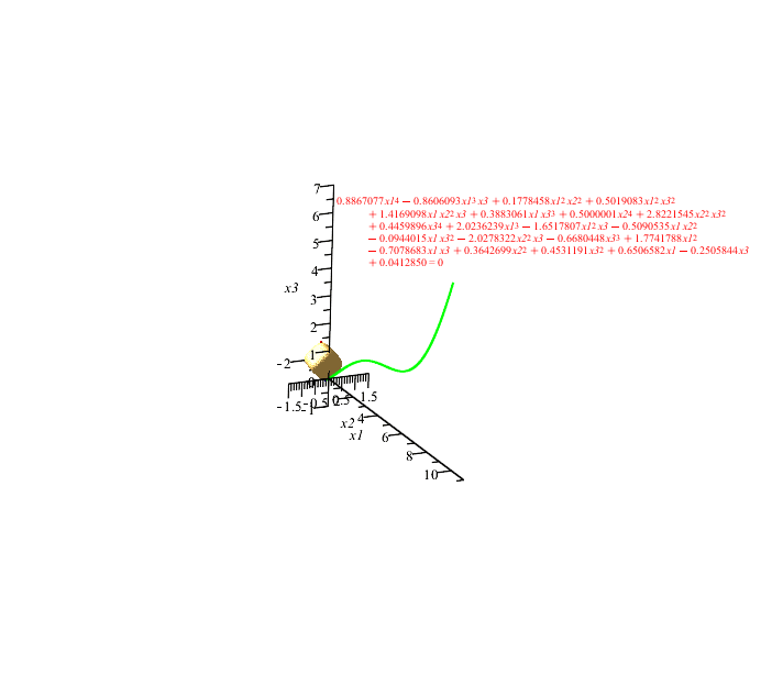

It seems to me that SMath does not yet has the capabilities, such as Maple, to execute some examples.:d
For example, Method Draghilev, however:

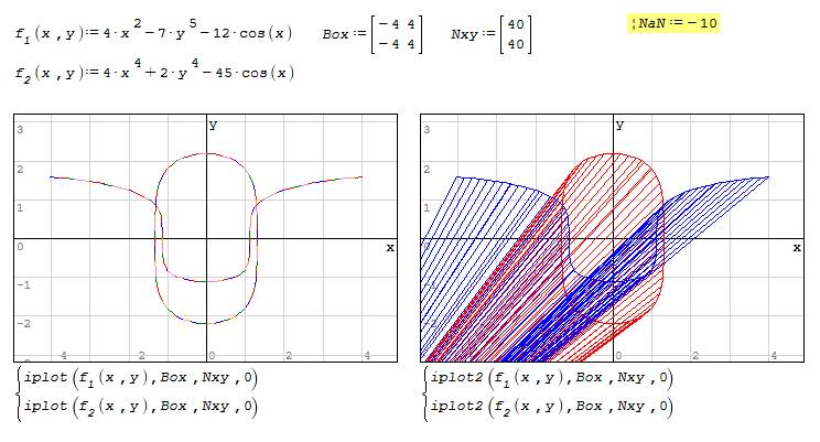

If you find some volunteers to code Tom G. Mathcad contour ... please feel free.
Hi Jean. Problem for code in SMath this procedure it's about that NaN is unavaible in SMath. Here you can see what happens without NaN, and a workaround of that:
https://en.smath.info/forum/yaf_postst12539_Implicit-Plot.aspx
iplotq.sm (40.7 KiB) downloaded 1565 time(s).
The iplot routine is from uni works in mathdcad.

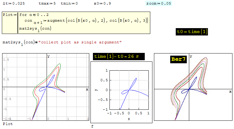

Dragilev method for equations with a parameter.Equations borrowed from Jean Giraud .
JeanContour1.sm (11.52 KiB) downloaded 1422 time(s).
Jean.sm (11.18 KiB) downloaded 1408 time(s).

#33 Posted: 2018/10/29 12:03:17
Thanks Ber7 ... Electron function works fine.
Loop function fails, Maple SS 6179 seems in cause [RootOf].
Tried to doctor, not to avail , Ah !

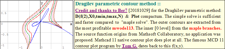

It works fine but can't nicely complete the 0 level loop.
It can be done otherwise for the interest of exporting.
This LaceLoop origin from Mathsoft Collaboratory... why ?
Mathcad 11 contour plot does nothing except absolute scrap.
So intriguing, that Tom G. made his own superb contour program.
Draghilev's Contour_2 Ber7 [Loop NO maple].sm (85.14 KiB) downloaded 1321 time(s).
Draghilev's Contour_2 Ber7 [Loop Reconciliation].sm (86.72 KiB) downloaded 1338 time(s).
