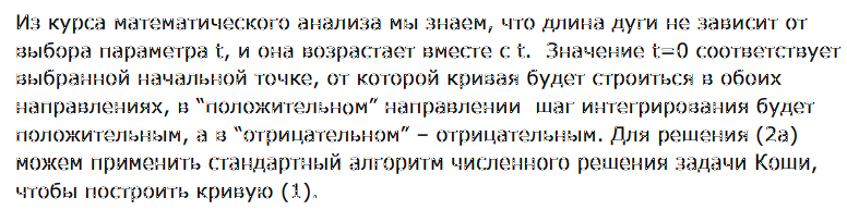

A lot. For instance, from the paper that you give as reference ( https://vk.com/doc242471809_437831729 ) can read:
"From the course of mathematical analysis, we know that the length of the arc does not depend on the choice of the parameter t, and it increases with t. The value t = 0 corresponds to the selected starting point, from which the curve will be constructed in both directions, in the “positive” direction the integration step will be positive, and in the “negative” direction - negative. To solve (2a), we can apply the standard algorithm for the numerical solution of the Cauchy problem to construct the curve (1)."
"We construct the curve (1), assuming that the length of the arc of the curve itself is the independent variable. The coordinates of the points of the curve will be obtained as a solution to the Cauchy problem for a system of ordinary differential equations, the initial data for which will be the coordinates of the previously known point belonging to this curve"
But the final parametrization isn't along the arc length.

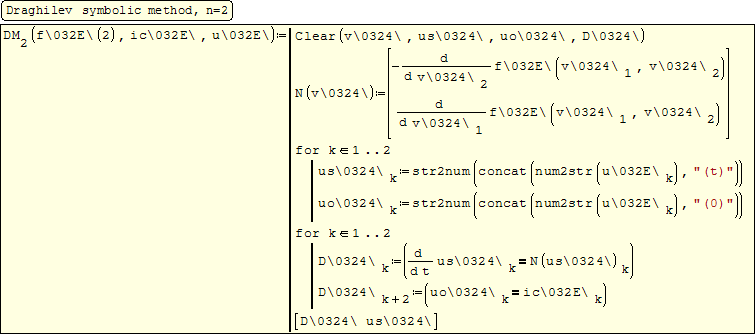

Hi Jean. Try this, in the last portable version (0.99.6839.38235):
About the coding below, is it the latest way to code 6839 ?
What kind of coding is that ?
Hi Jean. What you see is the unicode code for some ornaments. I use them because I don't like the use of x#, y# ... etc for each variable in the definition and body of the SMath procedures.
Maybe you don't have the unicode version of Courier New font.
#24 Опубликовано: 22.10.2018 19:00:26
Special characters mode is available since Version 0.99.6617, hence can't be rendered correctly in Jean's 0.98.6179 (no matter what fonts he has)
Please note that decorations aren't really needed since 0.98.6325 when Clear() was made built-in and that is enough to isolate line() procedures from external variables (useful in Jean's 0.98.6179, though)

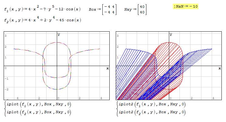

Hi Jean. Problem for code in SMath this procedure it's about that NaN is unavaible in SMath. Here you can see what happens without NaN, and a workaround of that:
https://en.smath.info/forum/yaf_postst12539_Implicit-Plot.aspx
iplotq.sm (40,7 КиБ) скачан 1815 раз(а).
The iplot routine is from uni works in mathdcad.

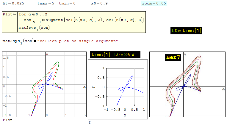

#32 Опубликовано: 28.10.2018 12:00:46
Fridel Selitsky
Fridel Selitsky
Dragilev method for equations with a parameter.Equations borrowed from Jean Giraud .
JeanContour1.sm (11,52 КиБ) скачан 1658 раз(а).
Jean.sm (11,18 КиБ) скачан 1633 раз(а).
Alvaro 29.10.2018 03:57:00

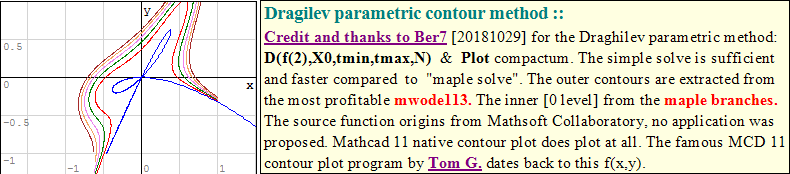

#33 Опубликовано: 29.10.2018 12:03:17
Thanks Ber7 ... Electron function works fine.
Loop function fails, Maple SS 6179 seems in cause [RootOf].
Tried to doctor, not to avail , Ah !
#34 Опубликовано: 29.10.2018 18:51:50
... doctored: few cut/paste has like re-installed the codes,
Can't get the complete loop as yours, but pleased with other contours.
Thanks again ... gorgeous Draghilev/Ber7
#35 Опубликовано: 30.10.2018 01:56:02
Fridel Selitsky
Fridel Selitsky
Jean, try without a maple.
Jeansolve.sm (11,06 КиБ) скачан 1658 раз(а).
#36 Опубликовано: 31.10.2018 21:43:58
It works fine but can't nicely complete the 0 level loop.
It can be done otherwise for the interest of exporting.
This LaceLoop origin from Mathsoft Collaboratory... why ?
Mathcad 11 contour plot does nothing except absolute scrap.
So intriguing, that Tom G. made his own superb contour program.
Draghilev's Contour_2 Ber7 [Loop NO maple].sm (85,14 КиБ) скачан 1537 раз(а).
Draghilev's Contour_2 Ber7 [Loop Reconciliation].sm (86,72 КиБ) скачан 1553 раз(а).

Point chart. You can see that the distance between the points is the same(Version 0.99.6839)
Version 0.99.6839.sm (11,35 КиБ) скачан 1664 раз(а).
#38 Опубликовано: 02.11.2018 13:53:33
Thanks Ber7 for the Draghilev parametric method.
I'm in peace with myself from the attached reconciliation.
Bigger image in the document.
Draghilev's Contour_2 Ber7 [Loop Reconciliation] Copy.sm (152,47 КиБ) скачан 1551 раз(а).
